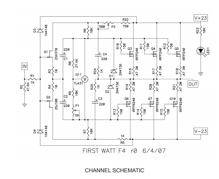

My motive for dragging the amp out is I am in the middle of project building a PASS First Watt F4 MOSFET source follower amplifier (zero gain). It is designed to take the output from a low power SET amp and deliver 25W Class A power (current) to speakers. I was thinking about using the Bugle to feed the F4, since it should have enough voltage swing to drive my speakers. Yes, I did do a GM70 SET build less than 2 years ago, but the Bugle is better sounding (within its limits), and with the F4, I should be able to have the drive.

Right now, I am just experimenting. If it is something I want to keep using, I can always pickup more used 45's or spring for pair of EMLs. I first want to see how they end up working with a First Watt F4 clone I am building.

First Watt F4 circuit looks like SS adaptation of Bruce Rosenblit's patented OTL design.

That's a joke, right.....?
PostPosted: October 12th, 2017, 4:29 pm
Posts: 1201
Why do you say that?
