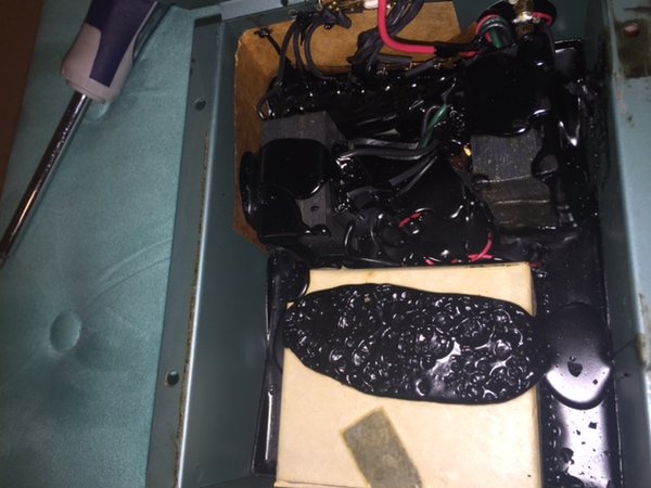

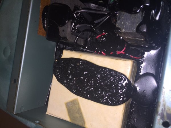

this is the photo of Altec N-500-D crossover used in VOTT A5 systems. I was using them with 9846 2-way monitors. Could not identify that square white box. Looks like it is made of waxed paper.

Altec liked to use coal tar for physical security to keep things in place -- with the side benefit of acoustic damping.
The box (I am pretty sure) is a multi-section paper capacitor to go with the inductors I see in the picture to form a second order crossover.

yes, it is a 2-order crossover supposed with crossover point at 500Hz. Even if I consider its 2 caps in a single package, they are big. Wonder how the compare sonically to new gen caps.

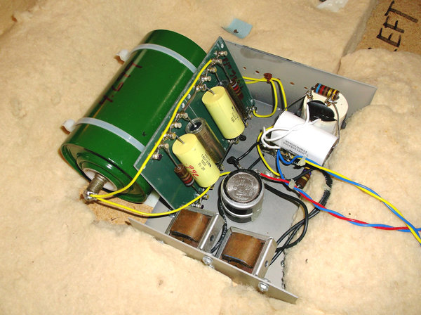

When I first got my Altecs on a whim I put them in my system stone stock to see what I ended up with. They were damn good and they had the stock paper caps.
But that was then and this is now. You will find that with patience and trial tests with different caps that the Altecs have a lot of quality there that the stock crossover was holding back.
I've attached a photo of what I ended up with after the third go at it. The big green "beer can" is Russian hermetic Teflon capacitor. The amalgam of capacitors you see in the picture was not arbitrary but the result of endless ear-testing trials. A combination of polycarbonate, polystryrene, and Teflon caps populate the terminal board for the high pass function, and the low pass was comprised of just polypropylene caps since they were in shunt and not horribly critical. The resistors provided damping to eliminate series L/C resonances (ringing) that could be mistaken for mechanical issues.

I like the beer can. :-)

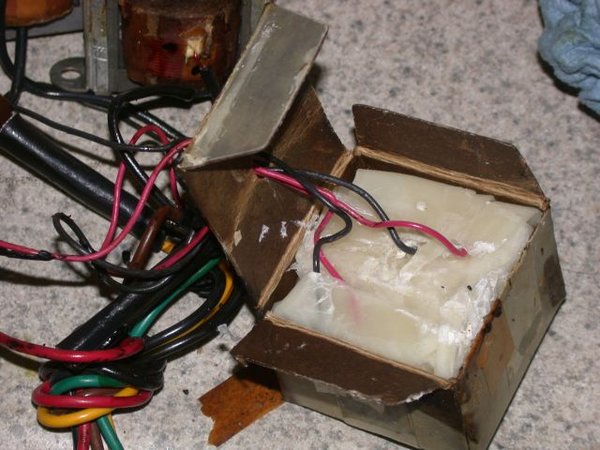

This is the housing of the caps in Altec N-800 crossover (Photo from another forum). What is the purpose of housing the caps in wax?

Potting the capacitors was not a matter of hiding the values as Altec was quite liberal with their schematics. The paper dielectric caps used were not wound as tight as modern film caps and could be effected by air-borne vibrations (sound) especially when they are inside the enclosure where the action is. Potting helps with isolation and enabling better sound reproduction. That's it. No hidden agenda just a goal of providing good sound.

Thanks Walt. That explains.
