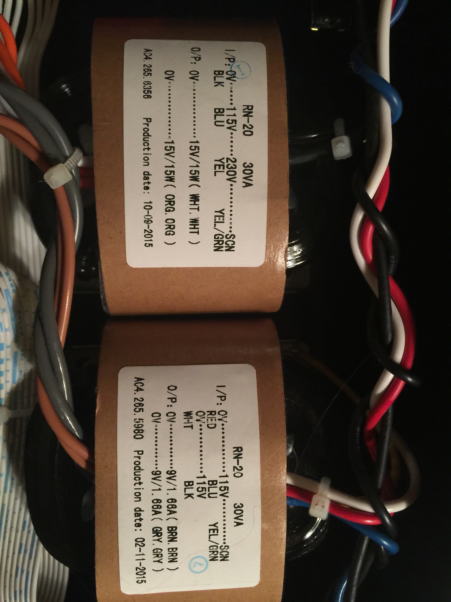

Recently I replaced the dual LME49990 opamps in the DAC with Burson Audio SS V5-OPD-S opamps which I had for a while. First day, they worked great, but from the second day onwards they are causing several distortion after about 10-15 mins of playing. The distortion is very severe. it sounds like clipping lower half of the wave at constant frequency (60Hz?). But, when I put back the stock LME49990 opamps,the DAC works without an issue.

The Burson discrete opamps draw more current, so if the power supply is marginal on the DAC, there could be an issue with power supply rails.
PostPosted: May 17th, 2017, 9:32 pm
On the other hand, from your photo, it appears your DAC may have a robust power supply (though depends on the regulators). Burson does say it is compatible with the LME49990, so there may be something in the way the opamp is used in the DAC. The LME 49990 is a pretty good OpAMP by itself.

David,
The power supply transformer seems to be 15V 1A and the filter caps are 6800 mu f.
Just came across TNT-Audio review which seems to agree with you.
http://www.tnt-audio.com/accessories/burson_supreme_e.html
Should I try increasing the voltage or the capacitance? I dont have an oscilloscope.

Really depends on the regulators. A +/-15 volt transformer should provide about +/-20V rails after the rectifier, which should be enough voltage headroom for regulator drop if using +/-15VDC to the opamp. If the design regulates to +/-18VDC (doubtful), then there could be a regulator dropout issue. I would think a 1A supply would be sufficient, but I think the DAC analog section may draw additional current in addition to the opamps.

The supply current spec on that amp is between 9 and 11 ma. You would have to have an awful lot of them to stress the supply. The output current is rated at 26MA and the short circuit current is limited to 75ma. I don't see the operation of the amps being a problem with the power supply unless it has a problem.

The fact that it is happening after 10 to 15 minutes of operation makes be wonder if there is a thermal issue coming into play. Do you notice if the regulator heatsink(s) are getting hot? Sometimes the heatsinks are undersized (or barely adequate) for the load, and if the Burson modules are pulling more current, it could increase the heat dissipation of the regulators.
