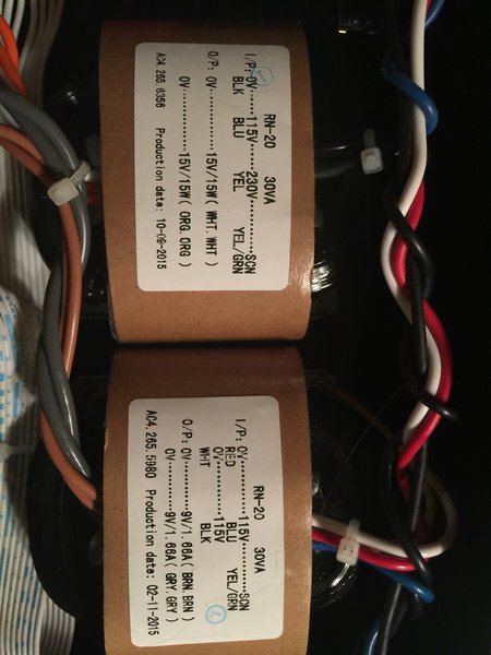

On the other hand, from your photo, it appears your DAC may have a robust power supply (though depends on the regulators). Burson does say it is compatible with the LME49990, so there may be something in the way the opamp is used in the DAC. The LME 49990 is a pretty good OpAMP by itself.

David,
The power supply transformer seems to be 15V 1A and the filter caps are 6800 mu f.
Just came across TNT-Audio review which seems to agree with you.
http://www.tnt-audio.com/accessories/burson_supreme_e.html
Should I try increasing the voltage or the capacitance? I dont have an oscilloscope.

Really depends on the regulators. A +/-15 volt transformer should provide about +/-20V rails after the rectifier, which should be enough voltage headroom for regulator drop if using +/-15VDC to the opamp. If the design regulates to +/-18VDC (doubtful), then there could be a regulator dropout issue. I would think a 1A supply would be sufficient, but I think the DAC analog section may draw additional current in addition to the opamps.
