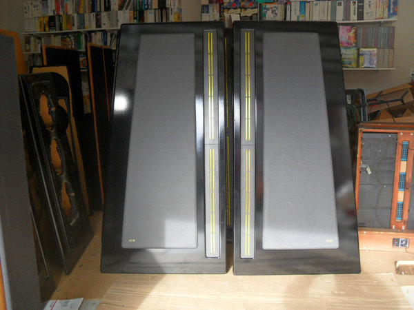

Like these with the 2 - 30" planar tweeters per side?

Yes those are my speakers.
