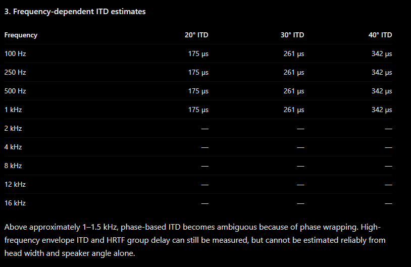

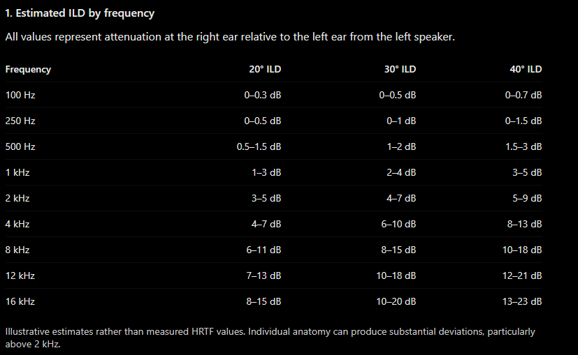

Tom,
Reading more on the subject, I gather the speaker placement plays a critical role in the crosstalk. I asked ChatGPT to calculate the ILD and ITD for 20, 30 and 40 degrees speaker placement from the center. At 40 degrees --compared to 20 degrees, crosstalk ILD is increased by about 6 dB at 4kHz due to head shadowing whereas the ITD increases from 175us to 350us. As the ILD increases, ITD becomes less relevant.
So, crosstalk reduces as the distance between the speakers increase. But then, we have to worry about side wall reflections.
That explains why I love my horns placed wide apart.

Edgar from BACCH suggests dipoles, horns, or else if using omnis, substantial room treatments to control early reflections. They not only interfere with BACCH but also regular two channel playback.
