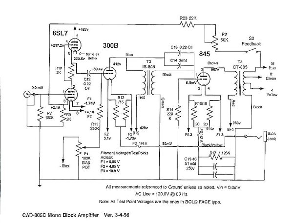

There is another way to get more power out of SET amplifier. Do what Cary did for 845,s and utilize a inter-stage coupling transformer with a feed-forward coupling capacitor to drive the 845 past where the grid goes positive.
A single class-A biased 845 can do 50-watts. In the case of the Cary amp. they used cathode bias. It's actually an old tried-and-true trick developed by G.E.
Or -- multiple 845s (or GM70s) in parallel as a "hot rod" SET.
No PP -- no crossover -- no phase inverter.

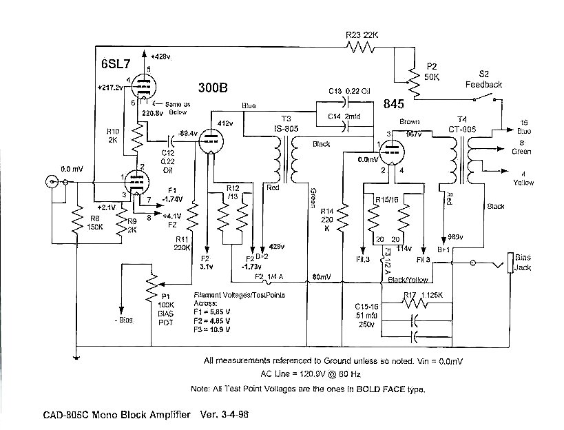

:character-oldtimer: Or, just use 833As ;). Good luck finding OPTs though... I have a pair of 833As in boxes, and a pair of sockets and the necessary 10V 10A filament transformers if you want to prove ot everyone how insane you are...

The Cary scheme is for driving the 845 into A2. It is the transformer that permits that, the grid will draw DC through the secondary of the interstage. A direct coupled connection from a cathode/pentode/MOSFET follower to the grid is best for A2, that is what I do with my 211 A2 SET amps. I agree that an A2 SET amp works well, and do not see an advantage of a PP DHT transmitting tube amp with all the overhead needed to support the extra tube. Actually easier to find an SE output transformer at the impedance needed than a PP OT.
I guess my main point was to make sure you actually need the power AND want a PP DHT topology for sonic reasons. Basically, if you can be happy with 20W, then all avenues are open, both reasonable PP DHT at a safer working voltage (using 300B) and SE designs with a transmitting tube (a GM70 SET will do 20W Class A and even more in A2 if transformer coupled), above that, there is much more complication. Class A2 is probably the least complicated way of getting more power, it is more a driver stage thing to get there rather than adding another output tube.
