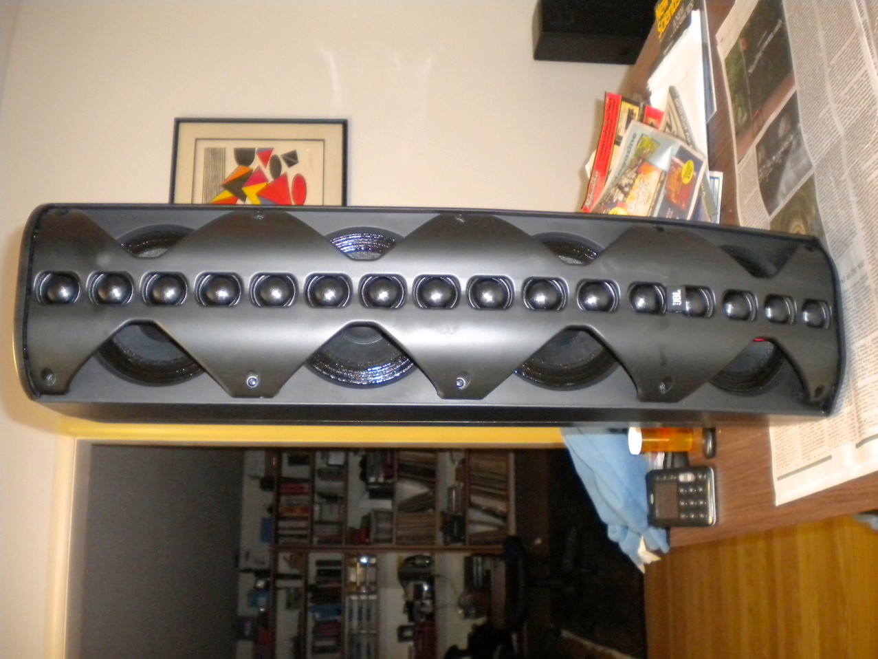

I just got my first JBL speakers for my home theater. The JBL CBT 70J-1. Here is a review of it -

That looks like a 6' tall speaker with 15" woofers. :-)

But seriously, I question the design.
About 50% of the woofers surface area is blocked and reflected back to the cone. Looks like the reflections are aimed back at the cone.

Look at the review. The obscured speakers are 5" midranges. A subwoofer is required.
If the “cut-over” for these drivers is below 150Hz, what is in front of the woofer is transparent and will only mildly effect the dispersion (very large and omnidirectional waveforms)- JBL has access to all the resources of Harman Corp, so this design (for sure) passed though an aechoic-chamber. Certainly a certified and engineered design.

Please just look at the review. The speakers were designed by Don Keele who wrote most of the book on speaker measurements ( https://en.wikipedia.org/wiki/D._B._Keele_Jr. )

cport wrote:
I am not talking about dispersion, reflections are the issue.
The concave metal baffle is merely couple of inches away form the cone. Reflected sound pressure would hit the cone negatively impacting its movement.
There is a reason why we do not see baffles blocking the cones in high-end speakers.
https://www.audiosciencereview.com/foru ... cer.21469/
Keele might have designed these speakers, but without information on the design criteria he was working with, one cannot make any judgements. Afterall, contemporary JBL is not a "high-end" company anymore. They are competing in low-end mass-production speaker brands like Yamaha and Sony.
