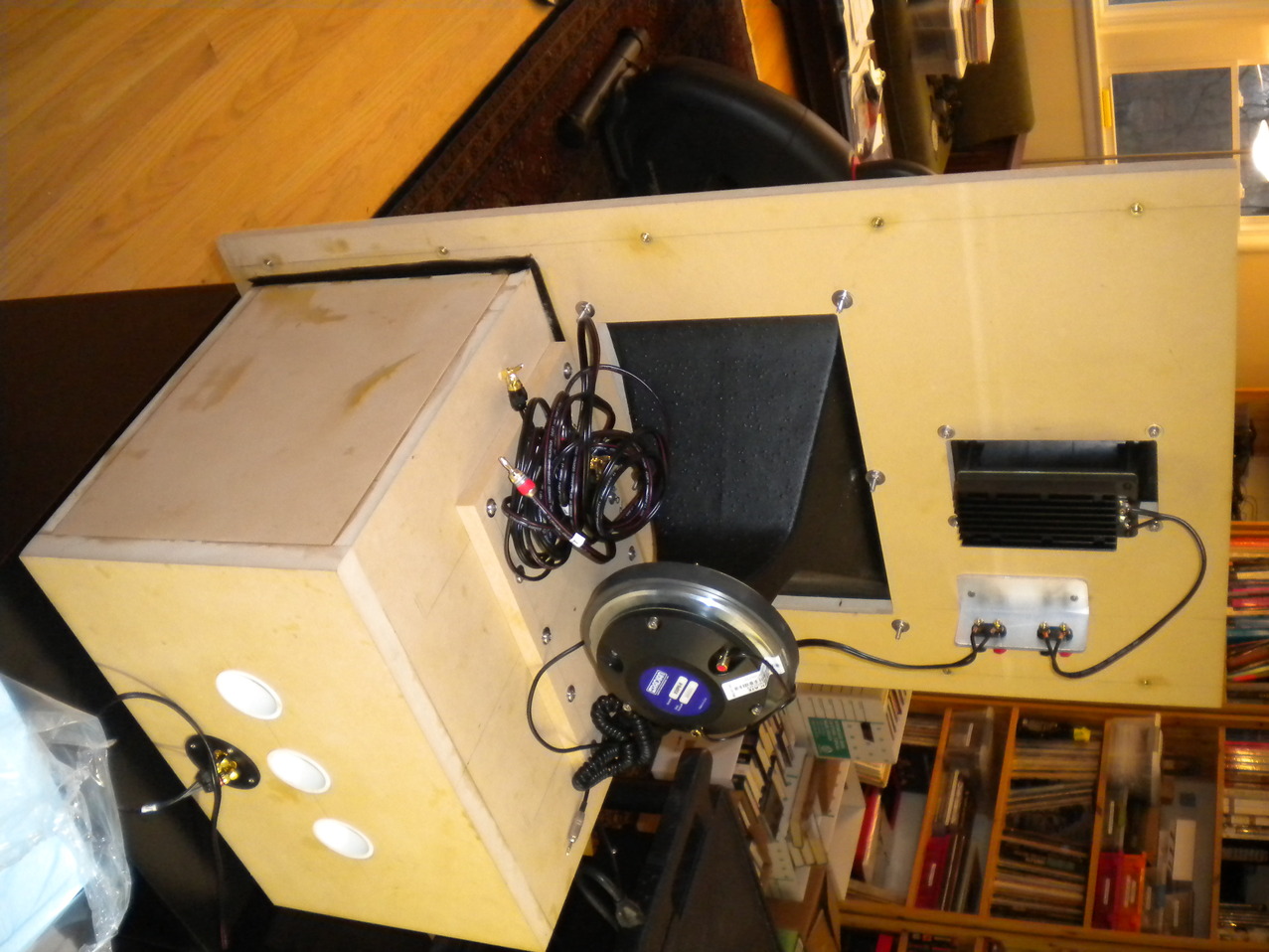

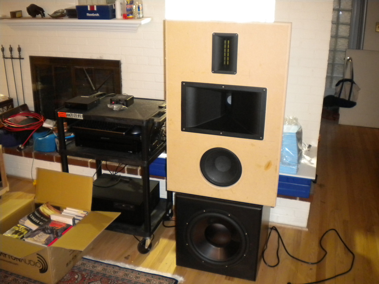

Update on speaker build -
The table on the left has the Amplifier (Emotiva Basx A6), miniDSP Flex 8, and HTPC. The subwoofer under the speaker is a Parts Express 15 inch driver and sealed enclosure kit.
