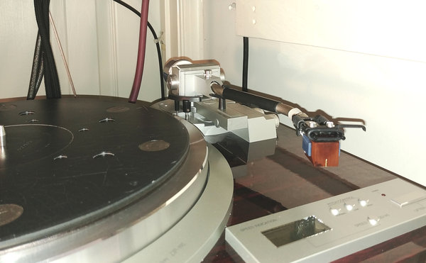

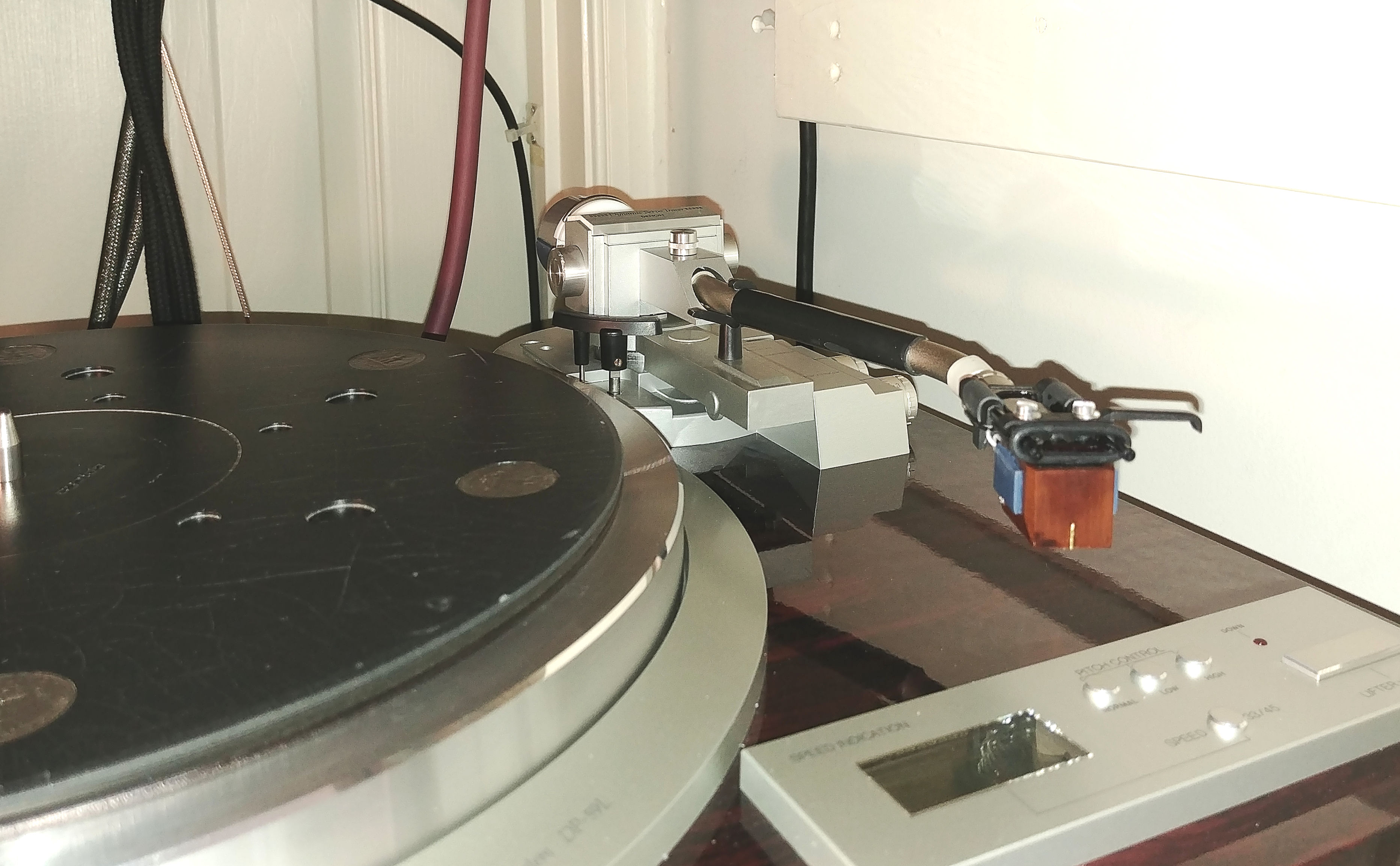

That's correct. I use 16-gauge lead sheet between the cartridge and tone arm. Additionally tone arms can be "calmed down" by encapsulation with thick shrink tubing.
