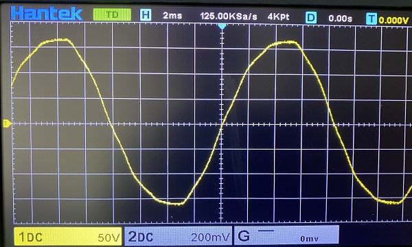

Given the fact that all linear power supplies are switching mode power supplies at mains frequency, the idea of re-generating a clean sine wave of 60Hz makes sense.
Look at how distorted the mains waveform in my home is. Not to mention the noise.
I think regeneration a clean AC is better than cleaning up the dirty power.

No such thing. If that were truly a requirement, the PS audio devices wouldn't work. Even a Behringer pro-sound amp can produce a 60Hz sine wave that's MUCH cleaner than the one you posted....
