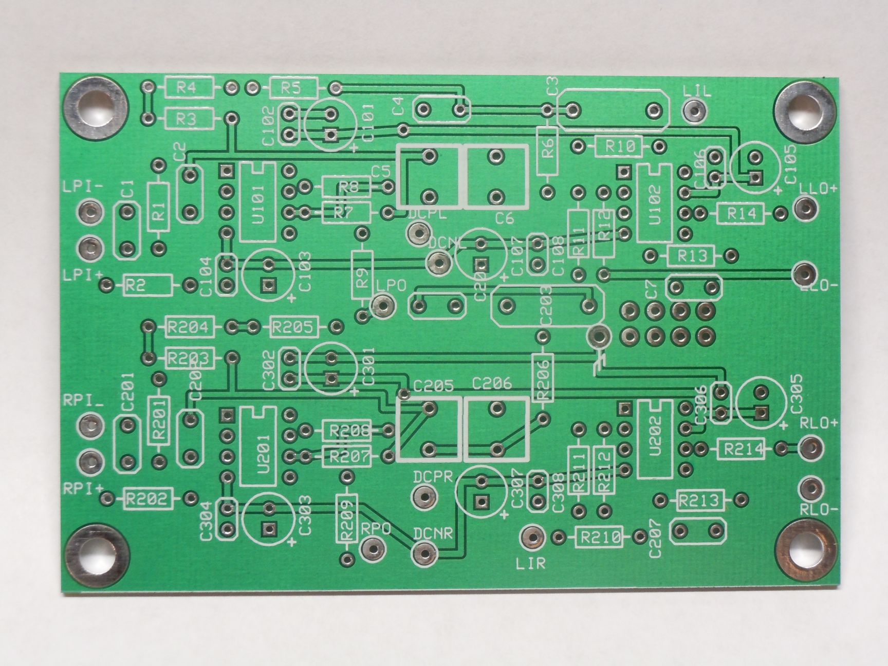

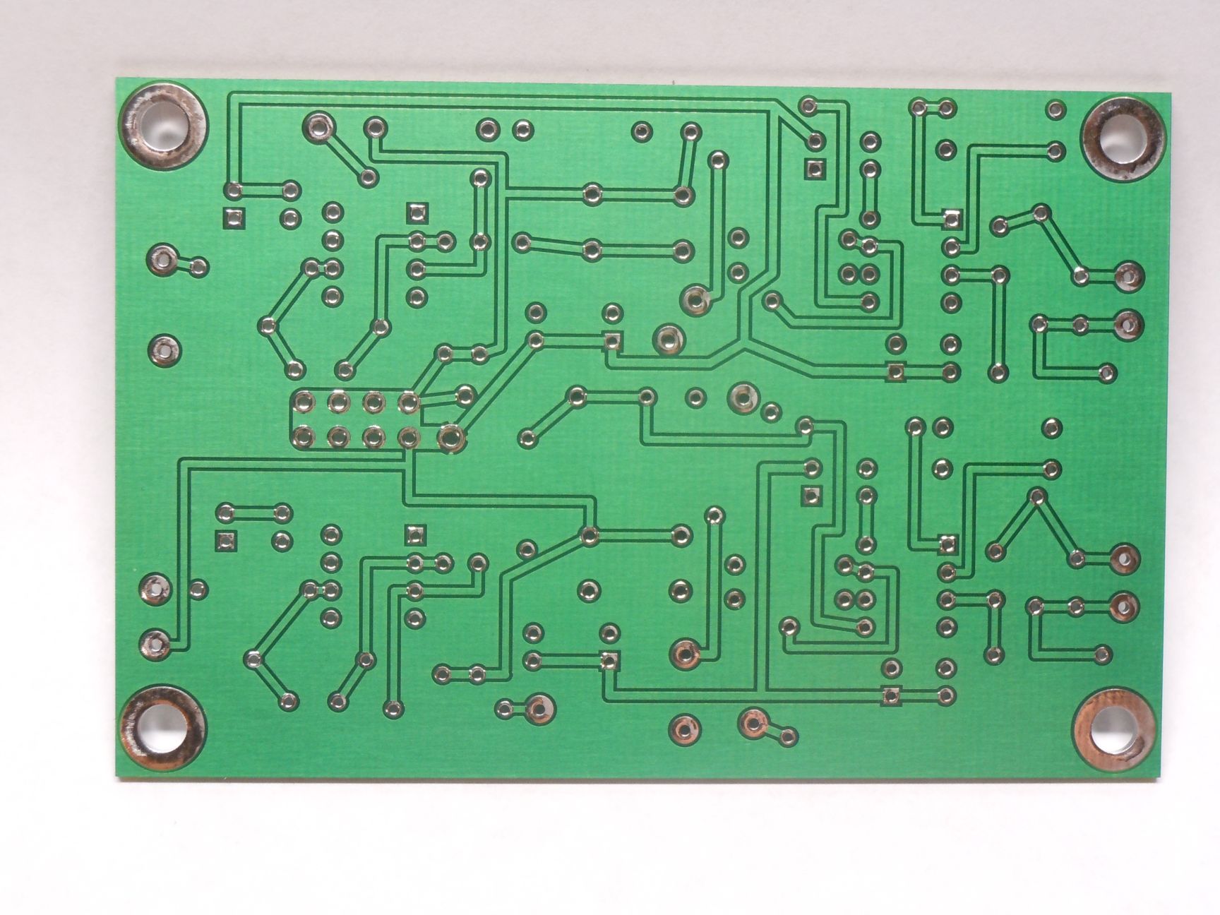

I agree that if it is a one off situation you are probably better off using Vector board with pins than going straight to a PCB design. When I make more than one off I use Express PCB because they provide the software and have reasonable prices for small runs. Here is a link to Vector and a photo of one of the boards that Express did for me:

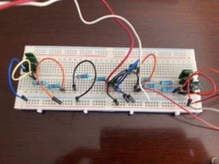

Few months ago I breadboarded a 3-way crossover using cheap caps and resistors from Amazon. Surprisingly, it sounded very good.
BTW, what resistors and caps do you recommend?
https://www.vectorelect.com/vectorbord-patterns.html
https://www.expresspcb.com/
Tom,
I will go with the PCB method. What do I need to take into consideration for the PCB?
Any recommendations on potentiometers ? I need them on each channel for level matching.
