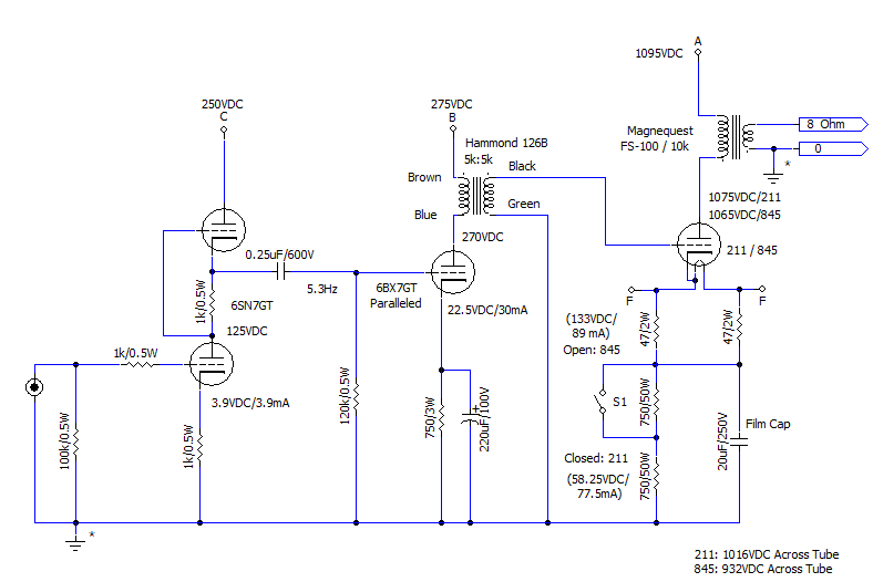

Here's an interesting project over at Audiokarma. I like this fellow, he's very sensible and always shows his work. If you scroll down a bit you can see the results--31 wpc at 5% THD. He was pleasantly surprised at the quality of the Hammond interstages. The OPTs were Magnequest FS-100s. He has another thread using an even simpler circuit with Hammond OPTs, I'll see if I can find it.
You could easily adapt this for GM70s.
