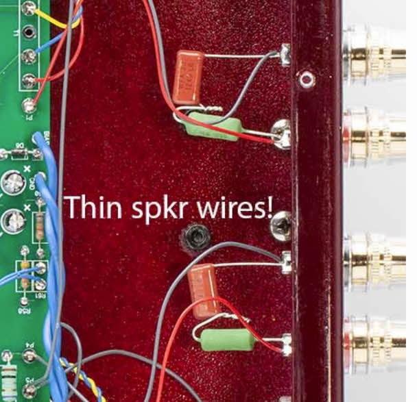

This is the screen cap of ASR Carver Crimson review. What are the Cap and resistor across the speaker terminal for?
PostPosted: January 22nd, 2022, 11:48 am
is it not what they call a zobal .
PostPosted: January 22nd, 2022, 11:53 am
:clap:
PostPosted: January 22nd, 2022, 11:56 am
Its just a filter. Some speaker manufacturers claim big black magic here.
