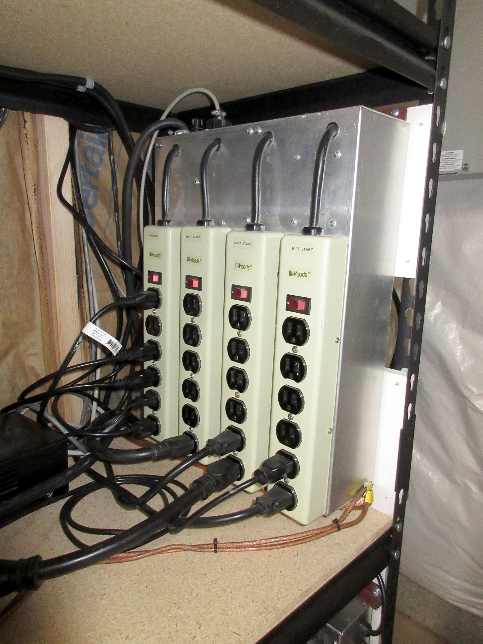

As far as running on a regular 120 VAC line, When living in MD, I was running my whole system including a true 5KW of amplifier power (two QSC 1310 and one Crown Macro Reference) on a shared 15 amp branch circuit. I never had a breaker trip because of the high peak to average nature of music, but I use a soft start circuit on my whole system to prevent turn on surges as all the storage caps in the different pieces charge up. If not, I'm sure I would trip the breaker.
In the current house, I'm running everything including over 7KW of amplifier power since I have added the distributed subs to the system powered by a Crown Studio Reference amp for a quad amped set up. It is on a dedicated 30 amp circuit and still goes through the soft start circuit. I'm including a photo of the equipment rack in the basement and the soft start circuit panel. It also has one power strip that is a straight on/off because some digital displays do not like a soft start. I'm including photos on the rack and soft start.

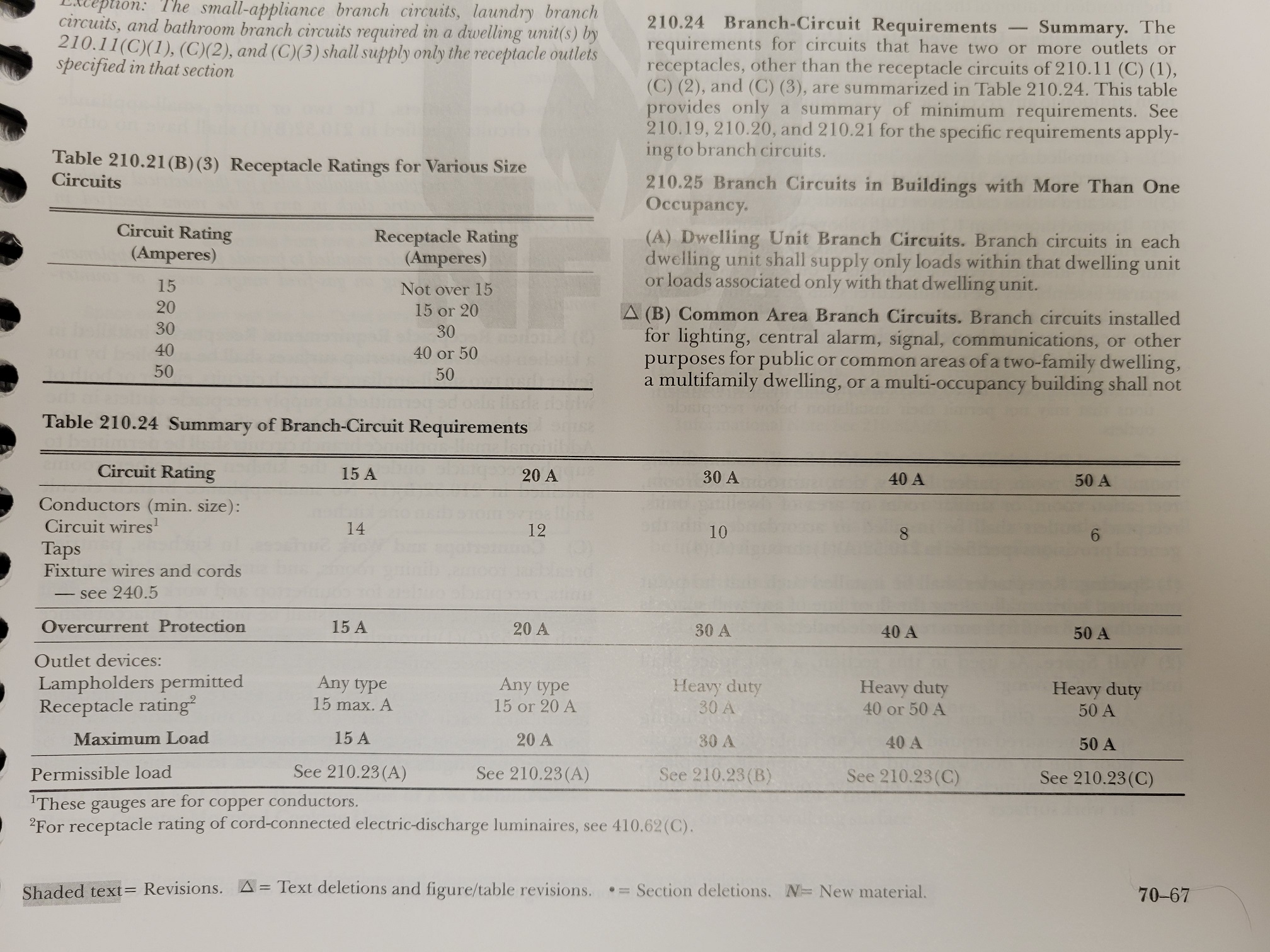

Tsk, Tsk Tom!
As an EE you know better!
Nema 5-15R receptacles on a 30 ampere circuit? Never! Clear violation of NFPA 70 210.23 and tables!
Try not to burn down your beautiful new home!!!!
:lol: :lol: :lol:
Just ball busting!
Slick

Tsk, tsk Stuart. Each power strip has it's own 15 amp breaker so each acts like a separate branch circuit. Input to the soft start circuit is appropriately wired and fused for the box capacity. The box then acts like a load center to feed the "branch circuits". That box comes off another box on the wall I built that feeds the soft start and also a standard NEMA 5-15R that is separately fused that goes to the UPS on top of the rack that is always on and feeds my music servers and other stuff that I leave on. This is not my first rodeo.
