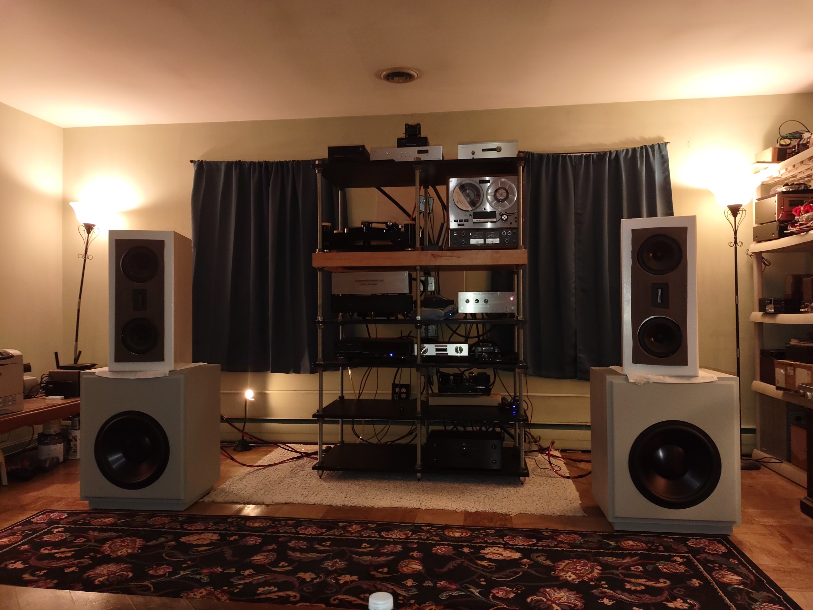

Thank you for the Altec 15 cabinets (and to Joe Roberts, who gave them to you). They've languished for awhile, but finally are in use as my new subs.
The cabinets were a bit flimsy and resonant for my tastes, so I laminated the bottoms with three sheets of 3/4" plywood, as a base, the front &rear with 3/4" MDF, and added bracing top-to-bottom, side to side and front to braces. All braces tied together internally. The cabinet is still just shy of 4 cubic feet internally. The new driver is a Dayton RSS390HF-4 https://www.parts-express.com/Dayton-Audio-RSS390HF-4-15-Reference-HF-Subwoofer-4-Ohm-295-468 15" woofer.
Sanded, then sealed the cabinets with shellac. Finally, rolled-on some fresh house paint.
I'm tickled with the way they turned out and how they sound. They are cut off at 120Hz, 8th order right now, a number that may lower as a result of experimenting. Also need to play with the DSP to smooth out the room a bit. But I'm very happy right now!
Thanks again!
PS, they are so heavy now, it takes two people to move them!

Thank you! Glad to see that worked out so well.
And - heavy (cabinets) is where its at!

Shashi,
No real argument here. Although the drivers I'm using I wouldn't characterize as "low" efficiency at 90+dB/W/M, but certainly lower than the Altecs and other drivers from the 50s-60s.
Since the plan wasn't to build a vintage-type system with low XMAX drivers, using an enclosure "gloriously" vibrating due to the back wave of the driver, was not in the plans. The path chosen here might not be right for anyone else, but my preference is to have as little box wall contribution to the sound in the room as practical.
In my advanced years I've had several opportunities to sit and listen to a few Altec systems, including the VOT (A7, right?). Not my cup of tea.
Tom P pointed out to me the rigors of getting a ported enclosure right, and after having tried a few times, I'm agreeing with his approach of building a sealed enclosure and using digital equalization to extend the low end. Bass watts are cheap, unlike in years gone by (where equalization was a lot more difficult also).
I have a another pair of enclosures, 5 cubic feet each, whose resonant point is allegedly out of the driver's operating range. That may be, but the bass from those boxes is so muddy that this project was undertaken.
So, for me, a rigid enclosure is needed.
Thanks for the input, you should drop by sometime!
