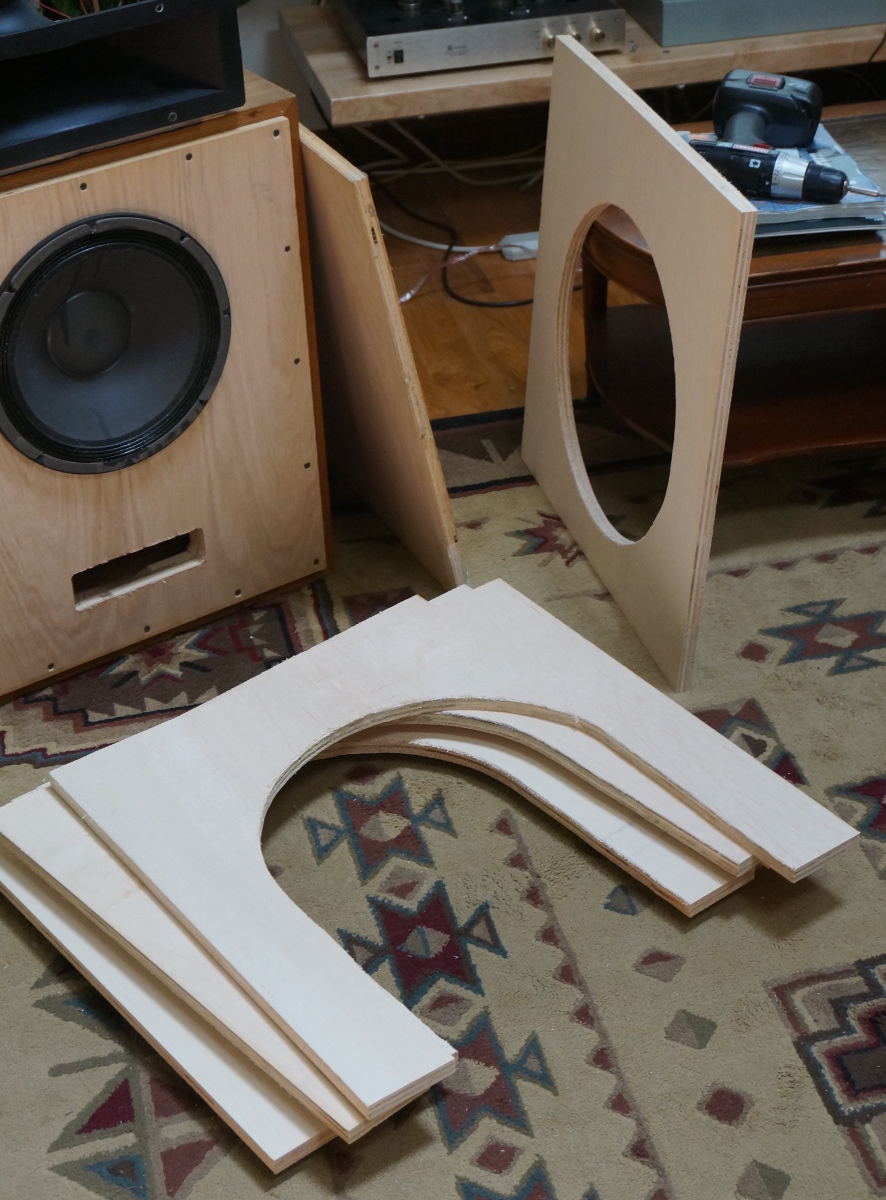

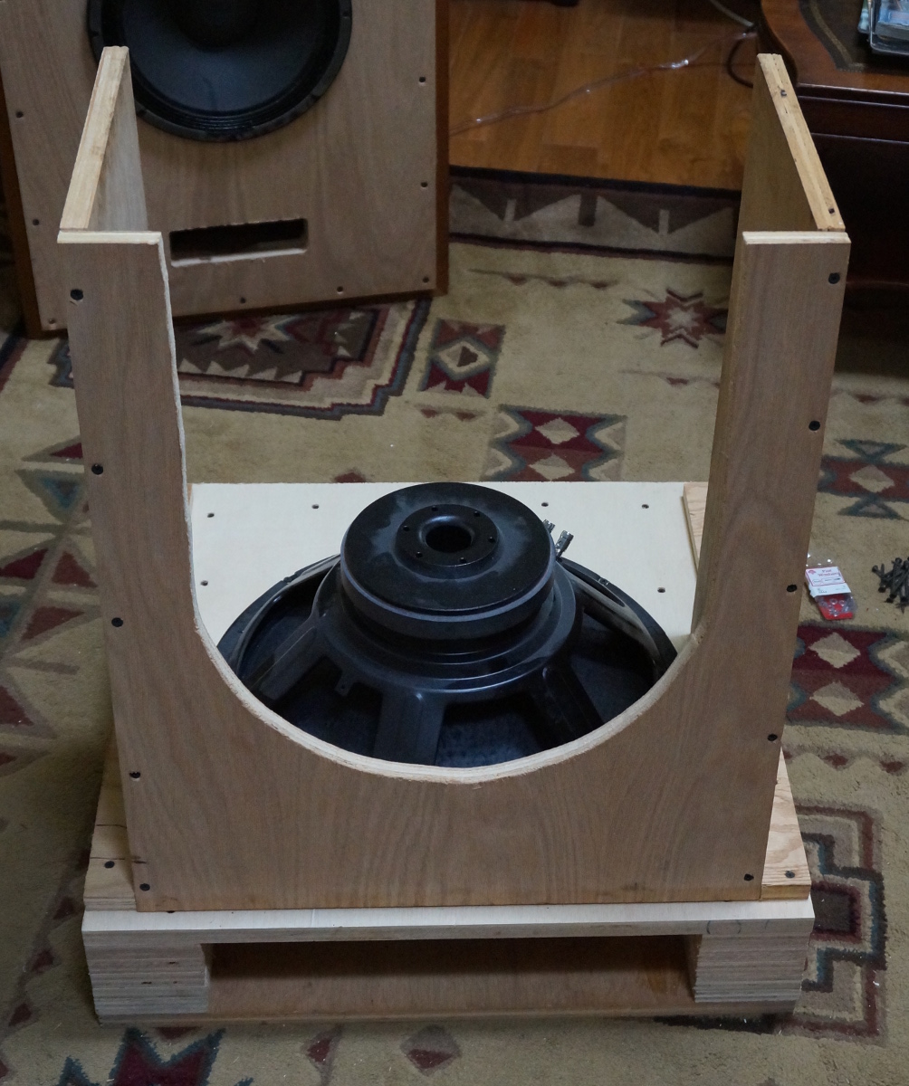

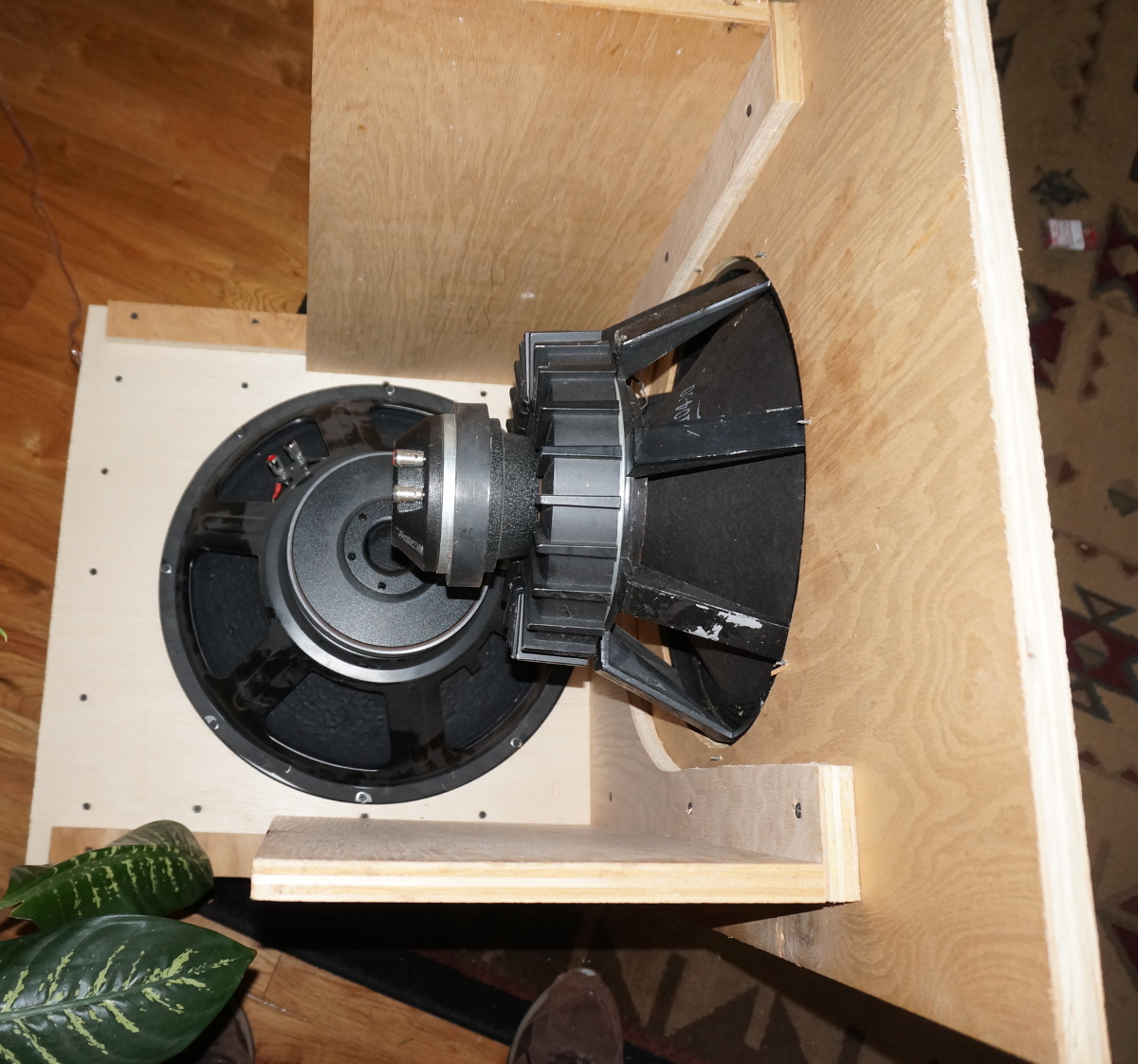

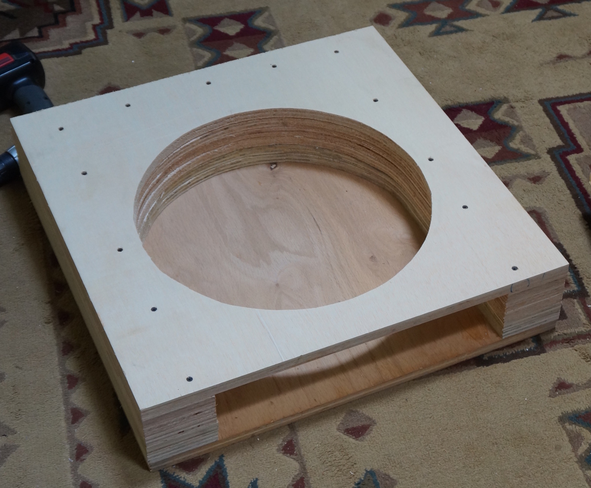

This weekend's project:
The pieces:

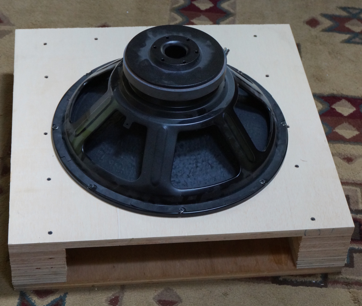

Ready for a driver:

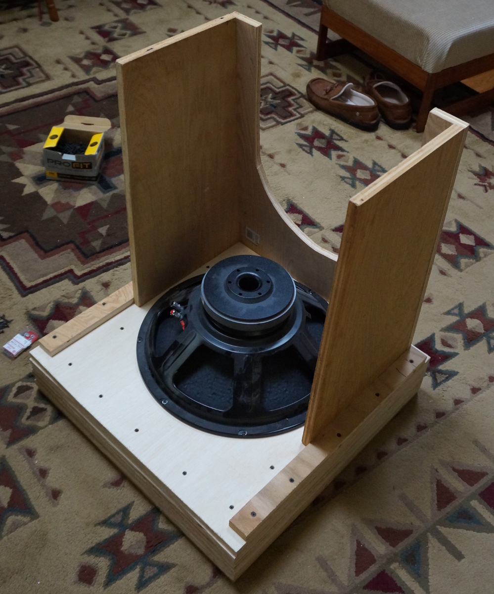

Dayton PA460-8 mounted:
Ready for a MF/HF baffle:
And a rear view:

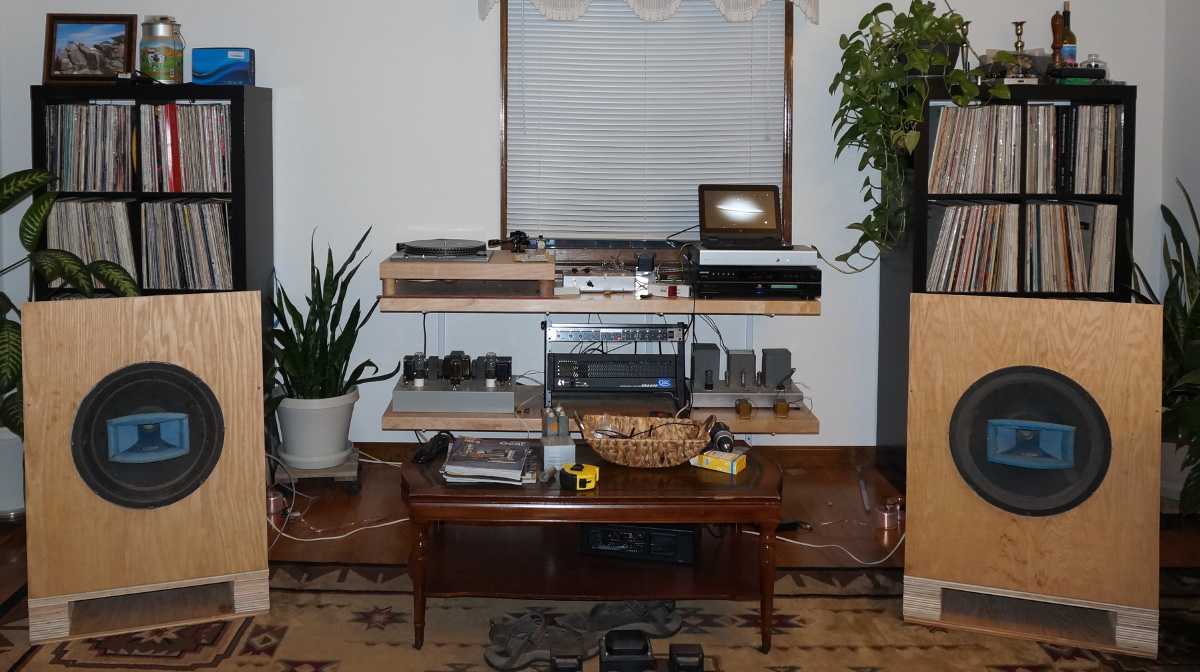

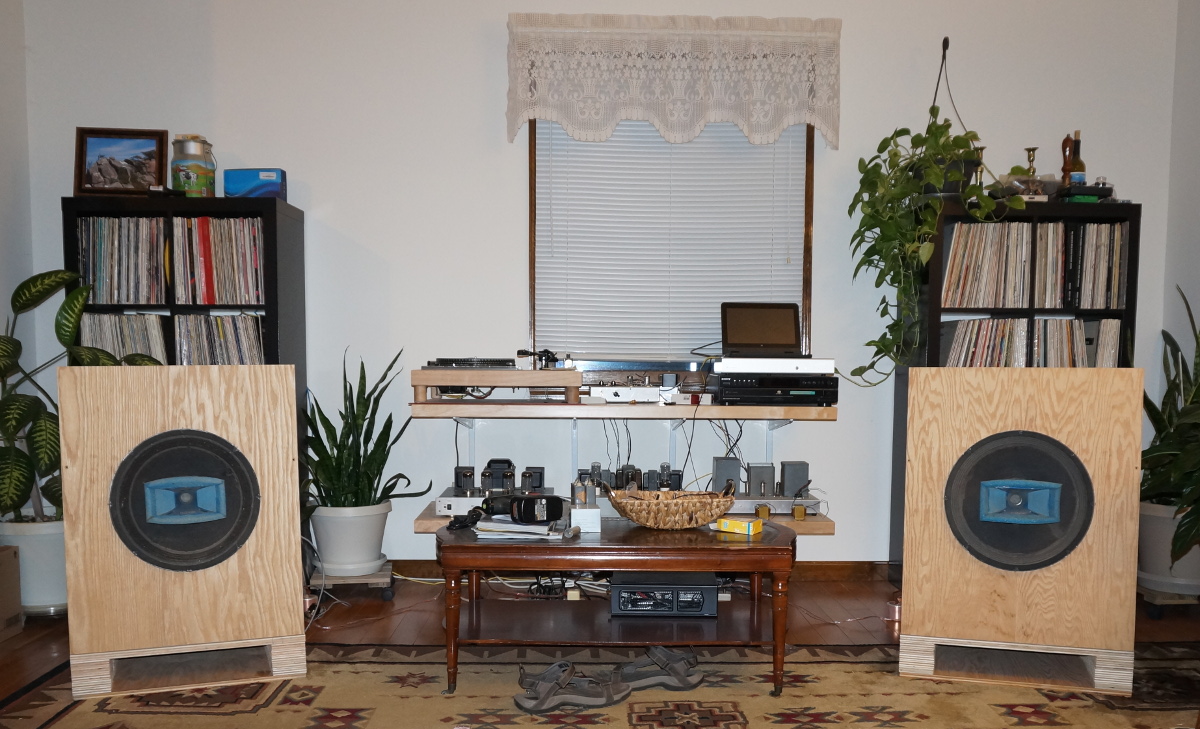

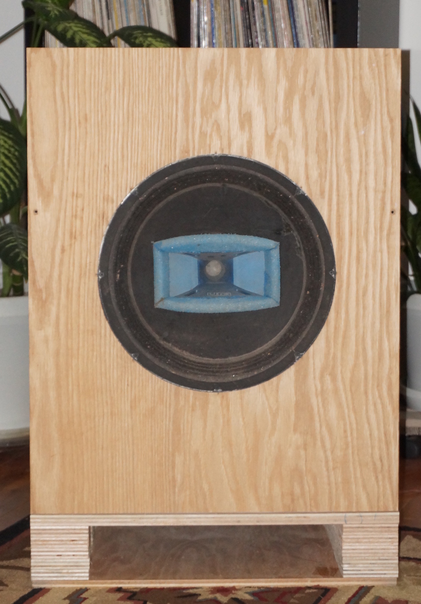

Ready to play:
Rear view:
I still need to build the other one ;)
PostPosted: May 1st, 2017, 9:19 pm
Second one done... Playing music, but no subs, the Ureis are running full-range. Bass a bit lighter than I've grown accustomed to ;)

Light bass, eh? Maybe larger baffles? I will have to see how my experiment plays out, I am using larger baffles so may get more support. I just got in the 8 MCM 10" drivers and should be in cabinet building mode.

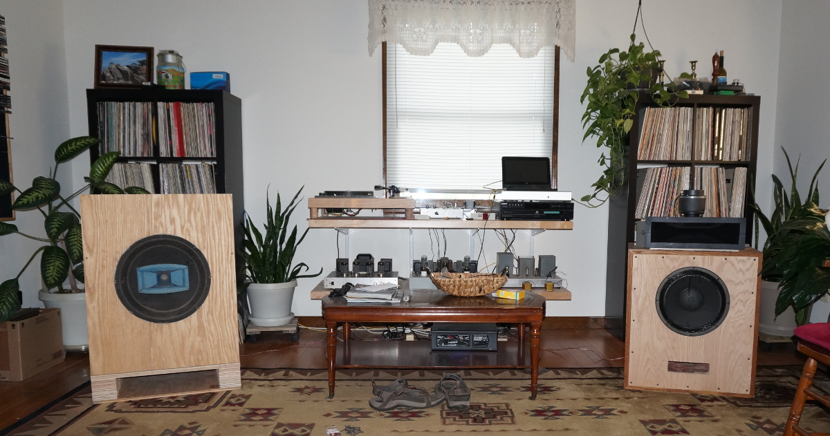

PostPosted: May 3rd, 2017, 12:26 am
Got the woofers hooked up and running this evening. Bi-amping, with SE2A3 for the Uries and a QSC amp driving the woofers. Xover is the Behringer CX2310 qhich we used at CAF in 2016, it sounded better than the DBX Driverack PA+...
Bass sounds quite good, doesn't go quite as low as the GW1858 on the JEL style baffle, but it's still pretty stout. Of course, the PA460 isn't the best choice for a SLOB, and the side wings could go a bit further back, but I ran out of plywood.

I spent a bit of time listening last night. Bass quality is quite similar the the GW on the JEL baffle. I think the only things gained with the SLOB are the ability to use a narrower baffle and the freedom to put the rest of the drivers in the best place on the front baffle rather than having to work around the woofer. I've got a pair of these: https://www.parts-express.com/dayton-au ... m--295-042 showing up tomorrow, and I've got the plywood to extend the wings to the rear of the base, so by this weekend I should have bass that goes as deep as it does on the JEL baffles with the GW driver.

The vertical woofer idea has possibilities, but that precludes having the bottom of the MF/HF driver(s) any lower than the top of the woofer, which wouldn't work with a tilt-back front panel like I decided to use to keep the height reasonable. You've still got to have either width or depth to get the path-length long enough... One of the cool things about the design I built is that other than the front baffle, the entire "cabinet" can be made from 2'x2' precut panels from Home Depot/Lowes which really simplifies the woodworking. The only difficult part is cutting the angle on two pieces per speaker to get the tilt-back on the front baffle.
