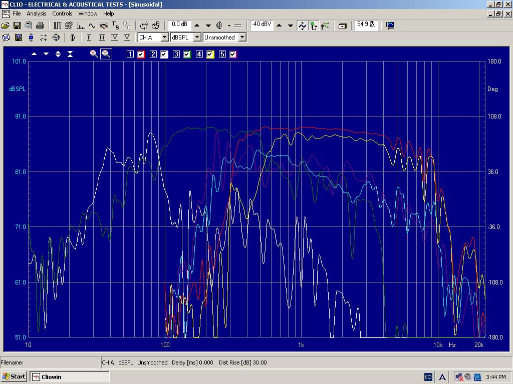

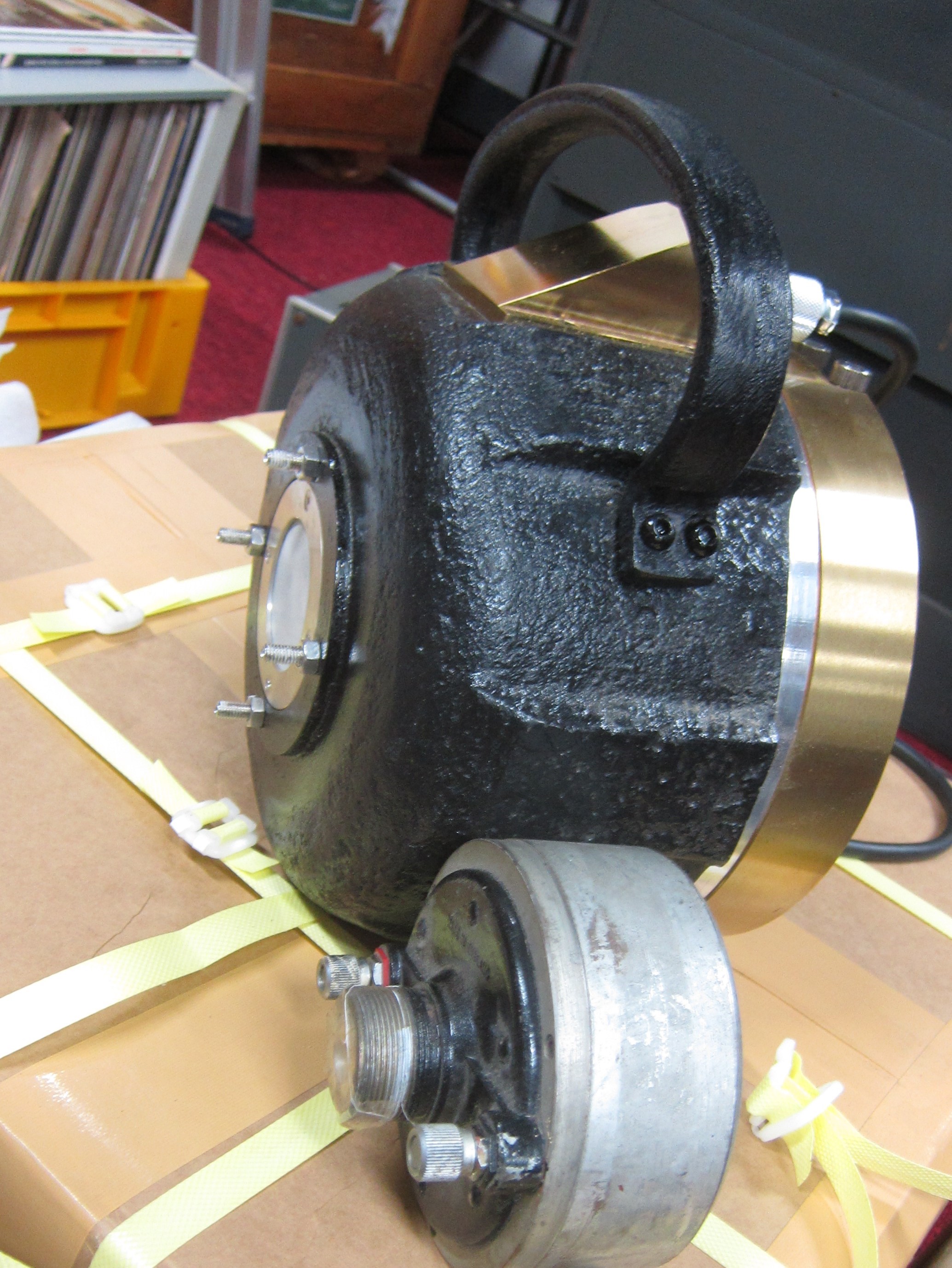

Found a few sweeps of the KL horn with a GIP replica WE594A beefed up with 20 extra pounds of permendur.
The red curve is on axis at a couple feet, the yellow curve is way off axis maybe 45deg @9-10 ft. Not referenced to 1V, we were just messing around trying different things I think the blue line may have been a real 594A on a 31A horn.
These sweeps are unsmoothed, BTW.
The big black driver in the pic is the GIP modified 594A.

I a question about sweeps.
I know most testers used them and they always look so bad.
I am just curious why are they used as opposed to using pink noise.
To my my of thinking sweeps have very little to do with the real world.

One advantage of sweeps is that they do not allow standing waves to form, whereas pink noise does. So sweeps may reduce room influence on measurements for those of us who do not have anechoic chambers.

In the case of the KL horn, I was much more blown away by the listening experience of Louis and Ella that day than the Clio sweeps. That is an unbelievably natural, smooth, and 3-D horn. Don't know how to measure that.

I posted the sweep of the KL tractrix because I think it does show technical excellence. Go measure 100 horns and see how many come up that flat. Flatness is a measure of well-controlled reflections in the geometry and at the edges of the horn. Waterfall will tell even more but FR is a useful index in this regard.
But if this 1930s design didn't SOUND exceptionally great, far better than most, I wouldn't be posting about it here.
