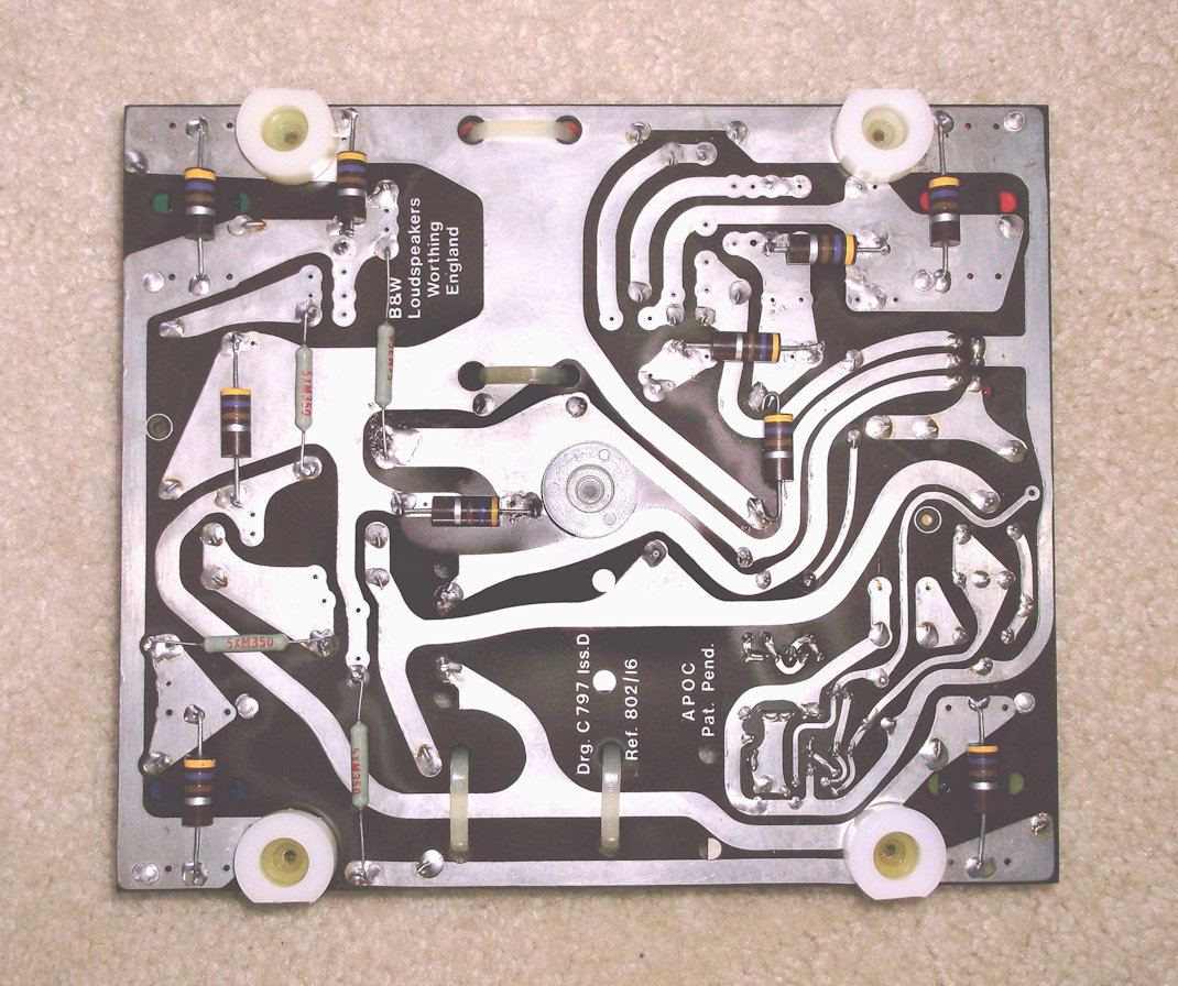

Attached are the photos of the upgraded crossovers. You’ll note that all but two capacitors were exclusively polycarbonates (ear-tested for the project) with hermetic Teflon bypass caps in the tweeter networks and WIMA polypropylene used as much reduced value shunt in the mid-range networks. You will note the small form factor Electronic Concepts caps designed for Mil-spec switch-mode power supplies and glass hermetic polycarbonate and Teflon caps designed for only God knows what. And my favorite tweak is the use of clamping resistors on each every capacitor and inductor to assure that those resonant reactance’s do not have snow-ball’s chance in hell of enabling those resonances.

. . . You’ll note that all but two capacitors were exclusively polycarbonates (ear-tested for the project) with hermetic Teflon bypass caps in the tweeter networks and WIMA polypropylene used as much reduced value shunt in the mid-range networks. You will note the small form factor Electronic Concepts caps designed for Mil-spec switch-mode power supplies and glass hermetic polycarbonate and Teflon caps designed for only God knows what. And my favorite tweak is the use of clamping resistors on each every capacitor and inductor to assure that those resonant reactance’s do not have snow-ball’s chance in hell of enabling those resonances.

First off, where do you get the EC caps? I noticed a few for sale on ebay but otherwise they seem hard to get. EC does have a website and I gave them a call but they're not particularly set up for small buyers. Their price for new caps in small quantity was really high even by audiophile standards.
Second, I'm curious if you have any rules of thumb for the clamping resistors. I would imagine that one just takes the impedance of the cap or inductor at the crossover frequency and multiplies it by ~100x and that would take care of it. From the pictures, it looks like you use 470 ohms a lot with the occasional 5K ohm thrown in there.

The caps you saw in the B&W crossover were scooped up from eBay. I keep a constant watch -- but I haven't seen any for some time. There are plenty fo that style in polypropylene (the EC model no. would have MP in the number as opposed to MC)
There are hermetic polycarbonate caps out there -- not EC -- but damn good. I have some large values that could be used in crossovers.
My original testing about 30-years ago (when I figured out what was going on) I determined an ideal 350-ohms across capacitors and 500-ohms across inductors.
Since then I found that it is not critical but you do not want to go lower than 350-ohms across caps or lower than 450-ohms across inductors. There were no 5-Kohm resistors used in the B&W. The gray silicon wire-wounds were actually 350-ohms. The "5" was part of the part number.
