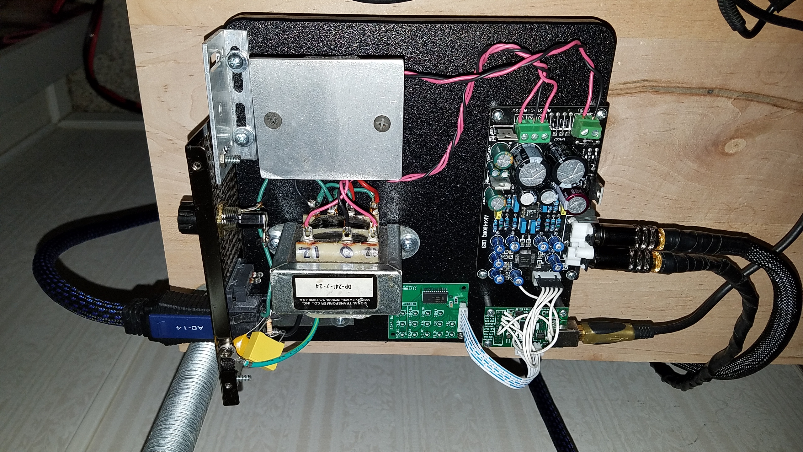

After hearing the little DAC that Rich of HAL fame brought to the show last summer, I decided to try one. Being cheap, I didn't buy the $100 Amanero USB to I2S board. Bought a cheaper one from DIYINHK.
Used what I had on hand to connect it up before, committing it to an enclosure.

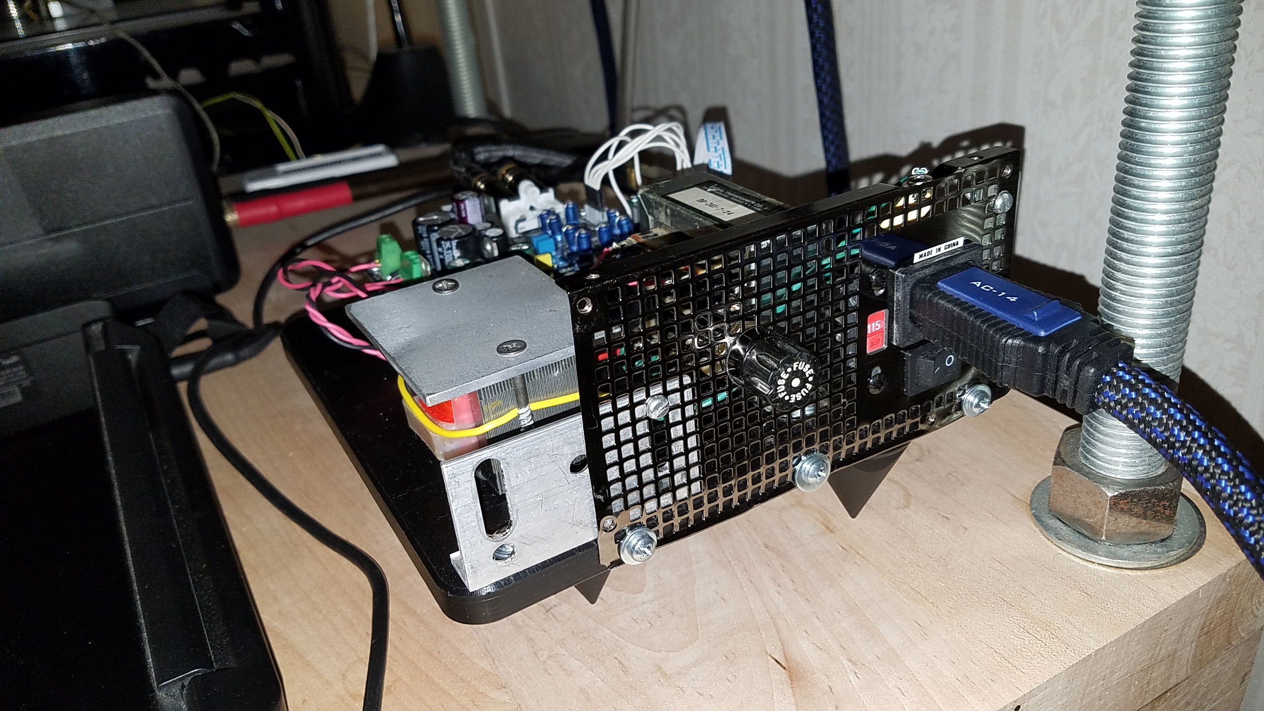

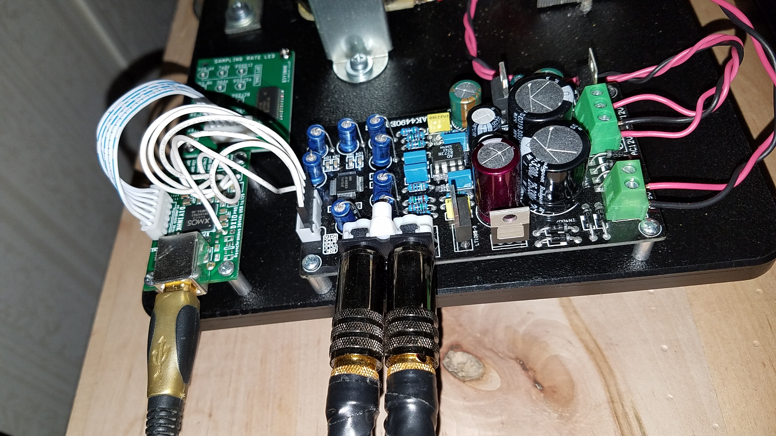

Pics

What is the power supply? It almost looks like a switcher...
 Post subject: Re: Hi-Rez DAC
PostPosted: May 18th, 2017, 3:50 pm
Posts: 928
Two transformers. Just need 25.2VAC CT and 9VAC to the linear supplies on the AK4490 DAC board.

Is there a schematic somewhere available for the DAC?
I'm interested in the possibility of building an analog stage off board. Not much room for good caps, etc. On the board.

Not that I know of. Probably just download the AKM AK4490 datasheet and look at the recommended design. Probably close.
http://www.akm.com/akm/en/file/datasheet/AK4490EQ.pdf

Yea, did that.
Looking at pages 62 and 63, seems like they are using example 40 for PCM judging by the parts count. But how do they switch to example 42 for DSD? Or do they?
Also,since the DAC output is balanced,I was contemplating a balanced audio signal out. ......

They probably just use figure 40 for both PCM and DSD and forget about the one pole in the filter. You also have to switch the input I2S Bus wiring for DSD to other pins on my USB interface, so more than just the filter changes.

Thanks. That's what I thought. I'll probably just build the first version. Ordered a new board, just in case I screw one up (Not that that ever happens)
