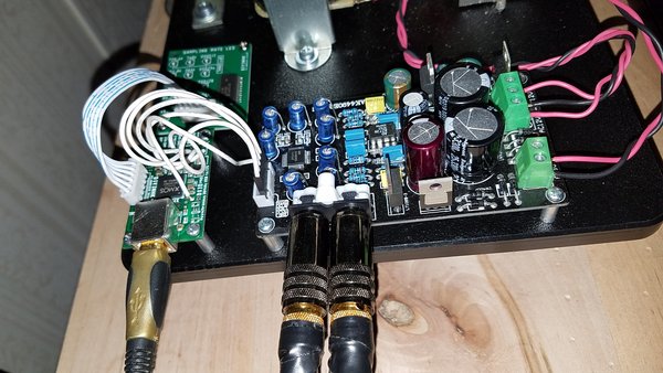

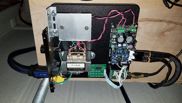

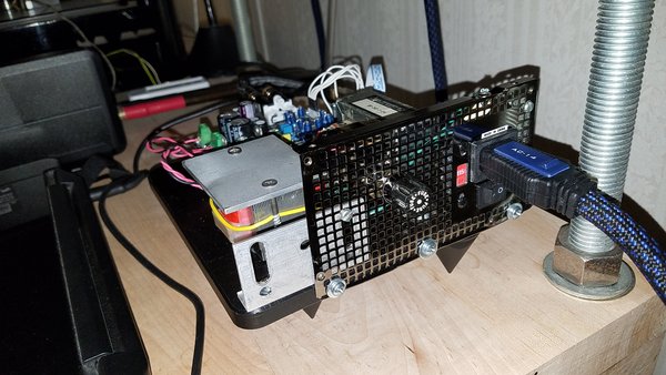

Pics

What is the power supply? It almost looks like a switcher...
 Post subject: Re: Hi-Rez DAC
PostPosted: May 18th, 2017, 3:50 pm
Posts: 928
Two transformers. Just need 25.2VAC CT and 9VAC to the linear supplies on the AK4490 DAC board.
