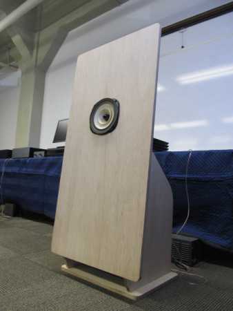

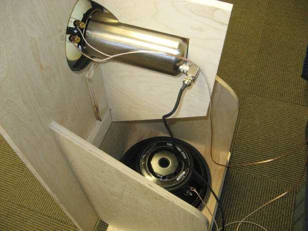

Well, I am wrapping around to the idea of a single driver slot loaded open baffle implementation, using a single 15" or 18" per speaker. There was a prototype system that Nelson Pass developed with a 15 inch Eminence Definimax-LF slot loaded at the base of a Lowther open baffle. This actually should work great with my Fostex/Aurum Cantus open baffle for an integrated system. With slot loading, you lower the F3 and raise the Qt for better open baffle extension, pickup a bit of directional gain, with the slot at the floor you maximize room gain. There are a couple of 18 inchers to consider, the Eminence KiloMax-Pro, and the Beyma SM-118n. I think this actually might be a bit more practical than dealing with multiple drivers. My intention is not to use this as a subwoofer, but to replace my current bass cabinet (which extends down to 40 hz) with an open baffle implementation. I will probably lower the current crossover point of 200 Hz down to 150 Hz (widening the Fostex baffle).
The attached pictures are the Nelson Pass implementation for inspiration (neat Lowther field coil driver!). My intent is to run it passively, which means I may have to extend the back of the OB frame further to increase the baffle width to get more extension. I am sure Mr. Pass uses one of his high impedance current amplifiers and a bit of equalization.

Like I said, I've got 4 of the 18" Daytons (https://www.parts-express.com/dayton-au ... r--295-036), you're welcome to try a pair... Any more info on the design that goes with those pics anywhere?
