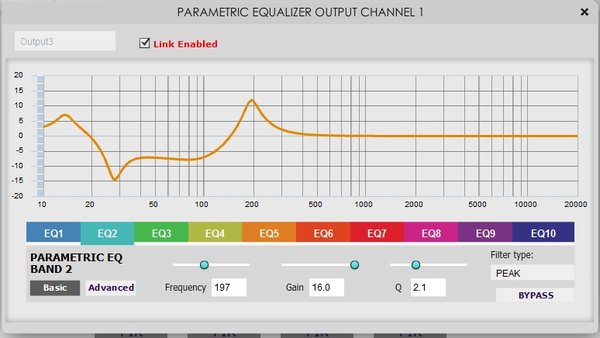

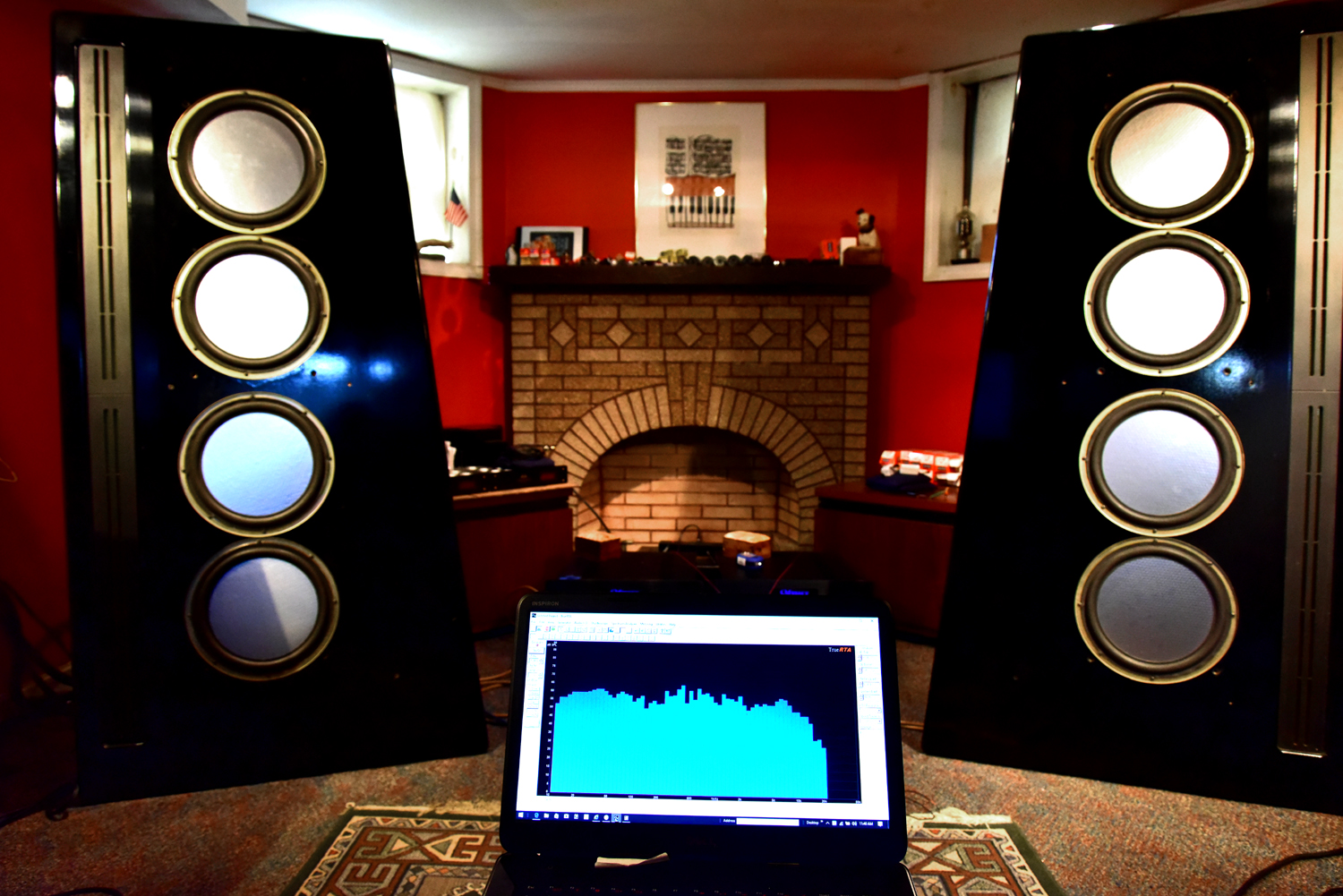

Alan Bromborsky (Brombo) handed over to me a couple weeks a go a pair of Calver ALS Original's, probably 1988 vintage. Stock these thing are a power black hole and I had nothing that could drive them past a whisper. What I could hear was pretty bad. I found some bad solder joints on two non working woofers and one rattling woofer's cone was delaminating from the honeycomb disk. With that fixed tings got a little better but I was not going to go shopping for a couple of horsepower amps.
Alan suggested to bi-amp with electronic xover. I have gon this way in the past with the Maggies and never got satisfactory results. Alan suggested the miniDSP-HD. I had tried the original minDSP and could not get past the digital artifacts, and was assured he new HD piece was much better. From a technological point of view this is one neat device. The software interface is really easy and you can adjust xover points and eq on the fly while listening. But......................
It has the same big HiFi glassy edgy sound of the modern commercial equipment out there.

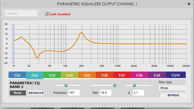

I really need the incredibly variable eq on the woofers as you can see in the screen grab. So the DSP is needed there but since 90% of the music comes from the ribbons (xover point is a low 150hz) I need something better for the Ribbons. I am looking a few options.
The really amazing part of this is I can drive these speaker to well over 100db cleanly with 200 watts per channel. The junky amp I am using for the woofers have power meters and when pushing 106db peaks the meters rarely went over 100 watts.

I think my complaint is the "digital" part. I feel I need to go analogue on the ribbons.

I do listen to digital source. I have music files on a NAS, and use a Raspberry Pi running Rune software as a player into my Twisted Pear Buffalo DAC vis USB. I accept the sound of a digital source as long as its musical. My serious listening is pure analog via vinyl set up.
My problem is when I inject DSP in the system, the sound becomes more HiFi than real. It has a glassy quality that chases me out of most hi-end megabuck systems I have heard at RMAF and Axpona.
I think I get the Carver ASL's to be musical if I get a decent analog xover on the ribbons, since the ribbons produce 90% of the sound coming from the speakers.
