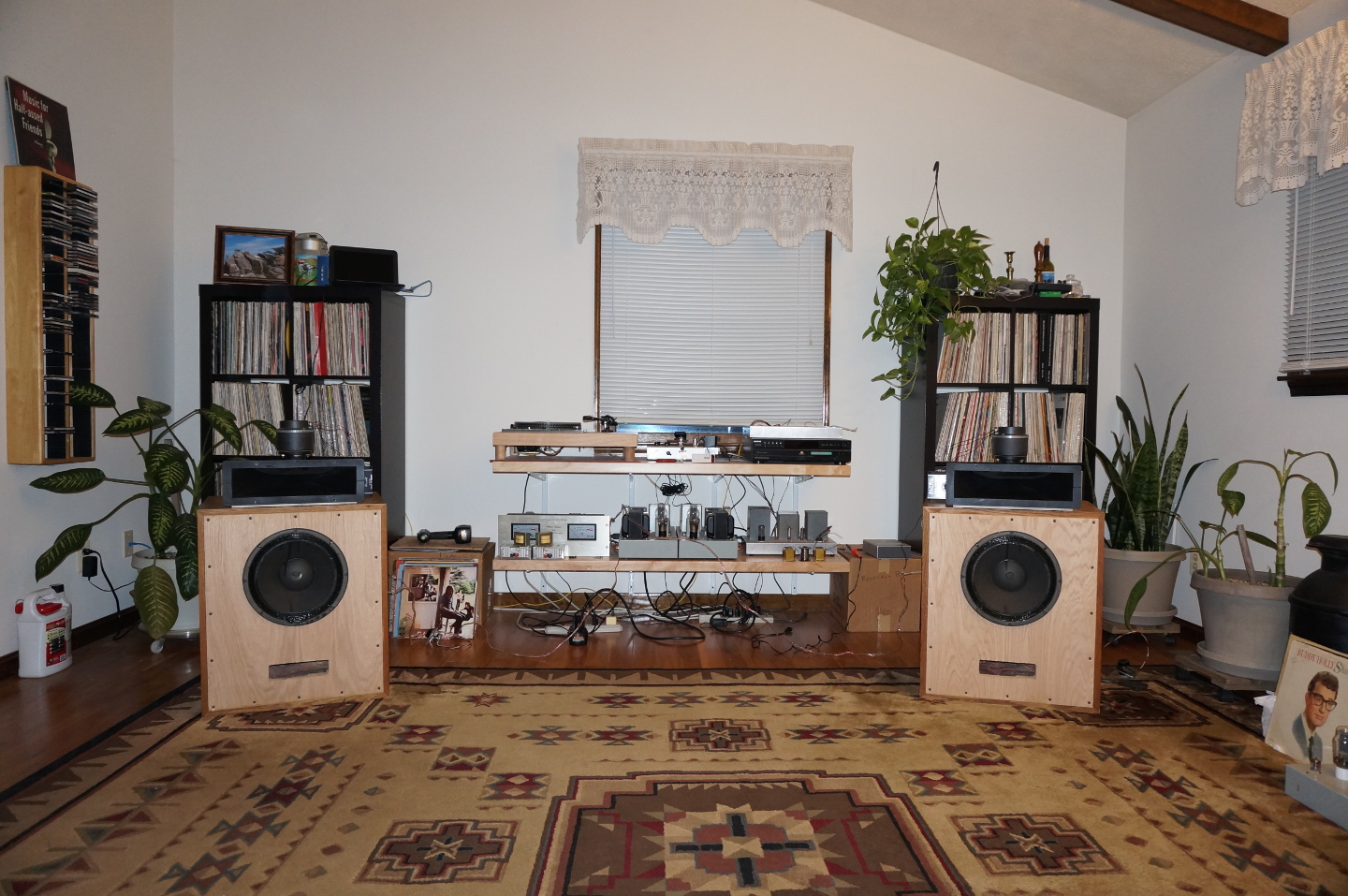

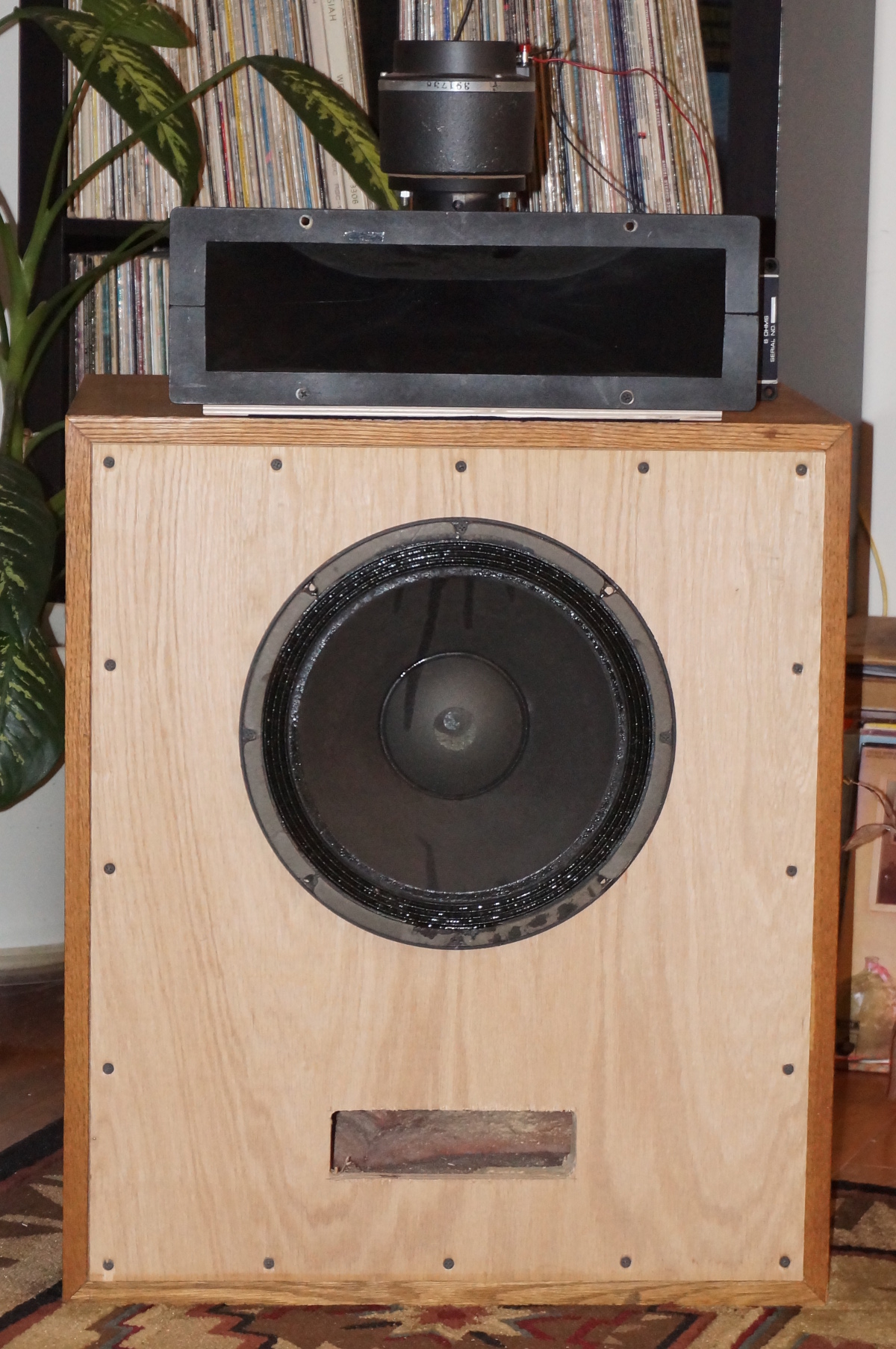

So, yesterday I got the 414s in the cabinets and put the 802-8G/32Bs on top. Using the stock Altec model 15 "crossovers" at this point. Crossovers is in quotes because it's actually just a high-pass for the 802, the 414 is run wide open (the model 15 used a different woofer).
Sound is a big step up from the Universitys, and will probobly be even better when I build a proper crossover later this week...

OOPS, cubic volume is bigger per comparison pic but footprint is about the same. Bass is 3X. So is weight!

I am confused. Since the backs of the woofer and the midrange share the same space wouldn't the spl generated by the woofer modulate the cone of the midrange causing doppler modulation of the sound generated by the midrange or does the back of the woofer and the slot equally load the front and back of the midrange?
PostPosted: January 15th, 2018, 7:11 pm
The back of both drivers open into free air.
How different is the LF pressure on the back and front of the 12" coax cone? Probably not that different.
There is probably some small measure of "flapping in the wind" but the system looks quite leaky in terms of induced pressure on the cones.
