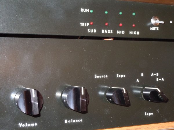

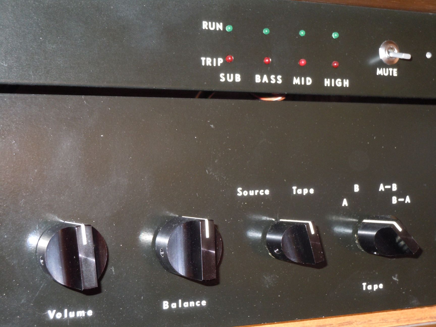

In the old days I used sheets of transfer lettering and then covered them with crystal clear Krylon. Unfortunately with the advent of computer type apps they are no longer available. I have also used a P-touch printer with clear backed tape. It's not as good as the transfer type but for non critical stuff it works quite well. The P-touch printer I have can communicate with an application on my PC so there is a very wide range of control over fonts, sizing, spacing, etc.

Thanks for the link on the dry transfer type. I'm going to order some. I also found another source:
http://www.pcbsupplies.com/dry-transfer-lettering/
Here is a photo of how I have used the white lettering in the past. It's a good low cost option.
