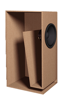

Also, at 3 cu.ft. Qtc of 0.64 isn't all that bad and I could do a Tapered pipe with slot loading. For a sealed, I could bolt the slot shut.

3 cu ft may not be enough volume for a proper tapered pipe or transmission line with a 12" woofer, unless you have good plans. If you do, then never mind. A solid, well constructed, thickwalled and internally braced sealed box will give great results. My subs are exactly that, with 1-1/2" thick walls (1-1/4" MDF + 1/4" oak plywood for cosmetics). I actually run them with a 6dB/octave bass lift electronically to provide more extension.

Edgar Villchur invented the acoustic suspension speaker system. His trick was to use a driver with a free-air resonance below 10-Hz. A driver with a free-air resonance of about 27-Hz. in a sealed box just won't get the job done. That said -- referencing the photo of the box with a tapered path -- that could be fiddled with in terms of fiberglass and/or wool fill to create a really cool transmission-line speaker that can get the job done. A word of advice -- do not use foam or polydacron for fill -- both are much too reactive and will create more problems.
