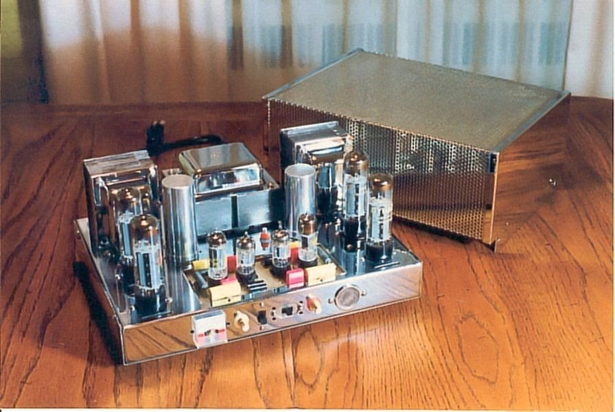

I did a ST-70 re-build in my evil past (see scanned photo) and found that the sweet spot for EL-34s was 38-ma cathode current for each tube. Any less and the sound gets edgy -- any more the sound gets dark plus you end up pushing the tubes harder than needed and shortening their expected useful life.
On the subject of balance -- the devil is in the details -- I have always used matched pairs in push-pull amps. The closer the match the better.

That is one good-looking amp! My 'st-70' isn't a real st-70; it uses 7591s as output tubes which have lower bias current.

Compliments are always welcome. I could not duplicate that effort again. The full differential boards are no longer available and Maryland EPA ended chrome plating.
A company in the city did mil-spec plating and anodizing. When I picked up the steel parts all plated and polished I was blown away. They far exceeded my expectations.
I did that amp. over 35 years ago. It is still running and spending its retirement years in Spain with its original owner who became a very good friend.
