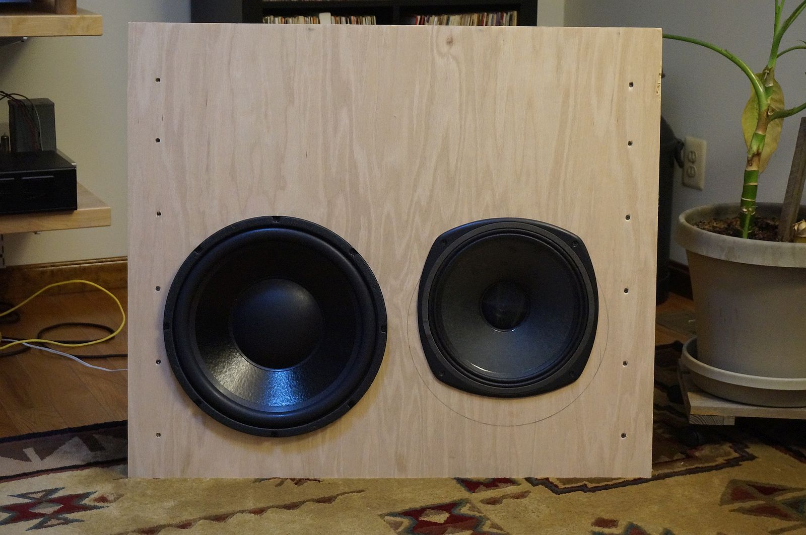

Time to play again with a new set of open baffle prototypes. These are setup for side-by-side drivers, with the Dayton Audio IB-15 woofer and a range of other drivers. First up is a pair of Tannoy 12" drivers from some late-model small commercial enclosures.
I'm also planning to try a pair of B&C 12" coaxials that I have, and the 15" Urei coaxials that I've used before. After that, I'll move to two of the IB-15s and a few different 8" full-range drivers in the gap above the 15s...
