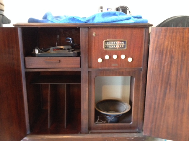

This is and has been mono console summer. Between about June and August I got three cool mono Hi-Fi consoles. One actually worked and is in mint condition. It's a Telefunken Empress which has their Opus 7 radio as its rig with a TW561 ceramic changer and 6 speakers: 2: 8-1/2" 2: 4" and 2: 2.8" electrostatic Ridiculously clean. The nicest old piece of Hi-Fi I've ever had. It's from 1957.

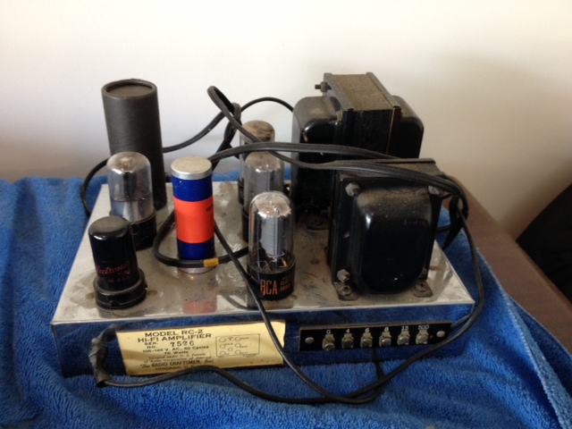

I got a Lafayette branded console with all Radio Craftsmen electronics and an Altec 600-4 driver. Very cool! All recapped and resistored and working. I don't know what to do about the RC-30 changer made by Webster. I can fix it w/ an idler and cart from V/W Gary Stork but it is missing a cosmetic trim piece. The Tuner/pre (RC-8) and amp (RC-2) are really sweet. I did a couple of cone tear repairs and it rocks. I actually had to make a new baffle board for where the speaker mounts and add grill cloth as that baffle board wasn't there. Luckily the Altec was.

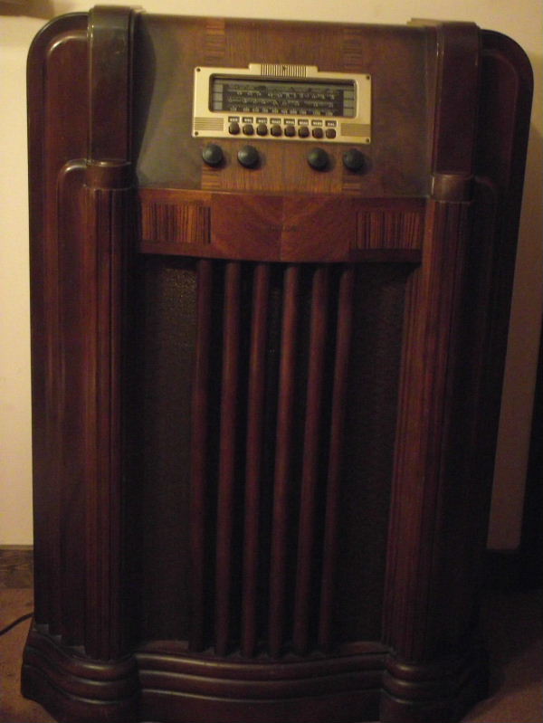

The last is a Stromberg Carlson 1210 which I rebuilt the Webster 56 (78 only) changer and did a recap, two tubes and a dial string and alignment. That thing puts out a lot of sound. it is 6V6 in push pull as is the RC-2

More pics , one more batch coming later that will include this and the S.C. in finished condition. I forgot to say on the Teklefunken that I have all paperwork including the delivery receipt to Henry Cherner and for those of you from DC yes of Cherner Lincoln Mercury. None of the paperwork included which was the owners manual, schematic, U.S. radio station guide (very cool) phonograph manual and a few other items looks like they were ever read.Perfect!
So the last story about this thing is it also had 6- 7" 78 RPM records with just an LP size hole that were recorded by the family in 1952 at a store where they had a booth and a record cutting lathe. One of the records is old Henry Cherner singing the original Cherner ad jingle. I digitized them and cleaned them up for the grandson I bought it from but he let me keep the originals.
Earl
5Y3,2-6V6, 6J6, 6SN7 in the RC-2
