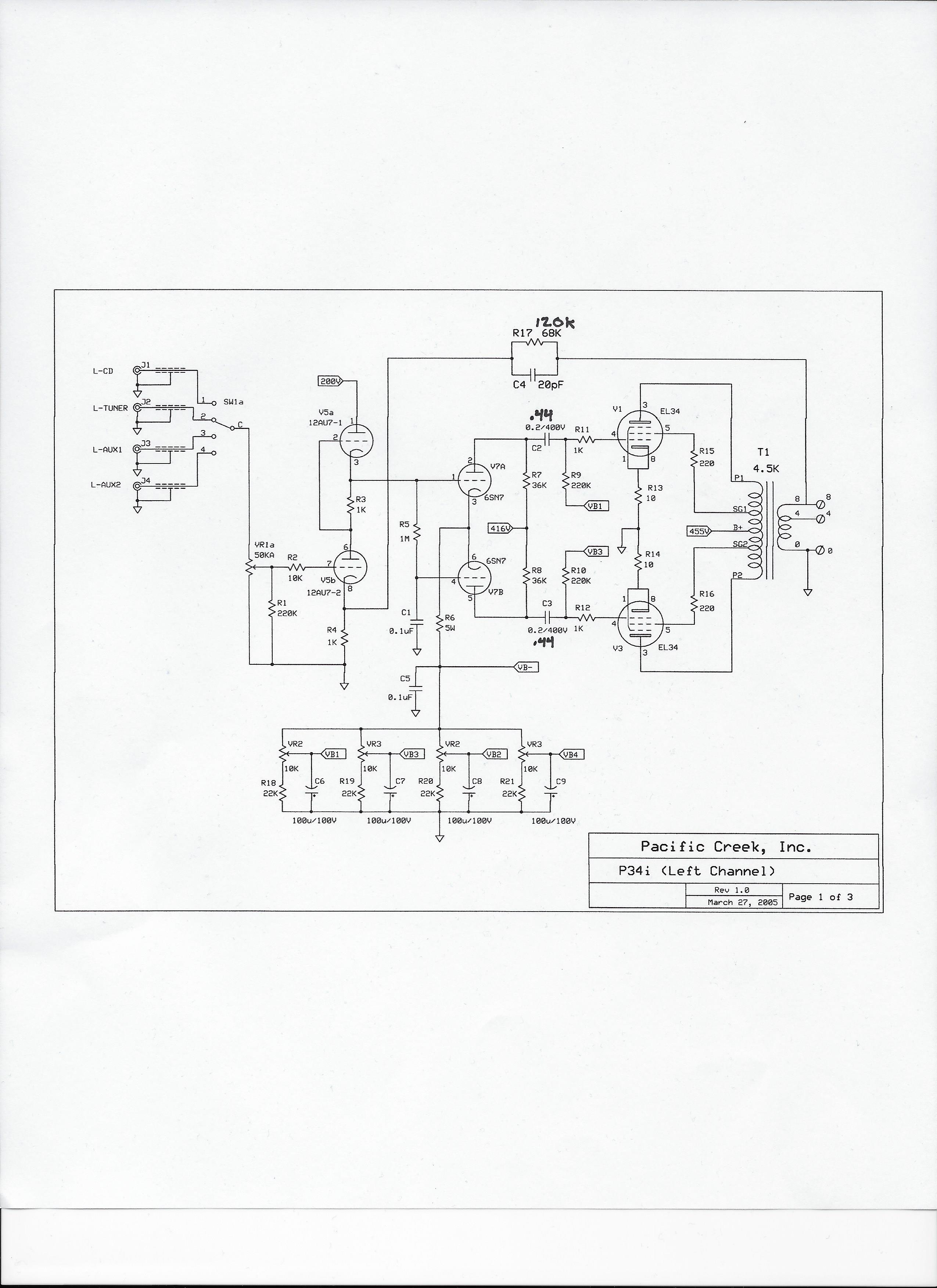

Did they provide, or can you reverse engineer the circuit? Is it the classic Williamson?

Yes, I have a circuit. I might be able to scan it an post it. I know how to identify all the components, but the topology doesn't mean very much to me yet.
