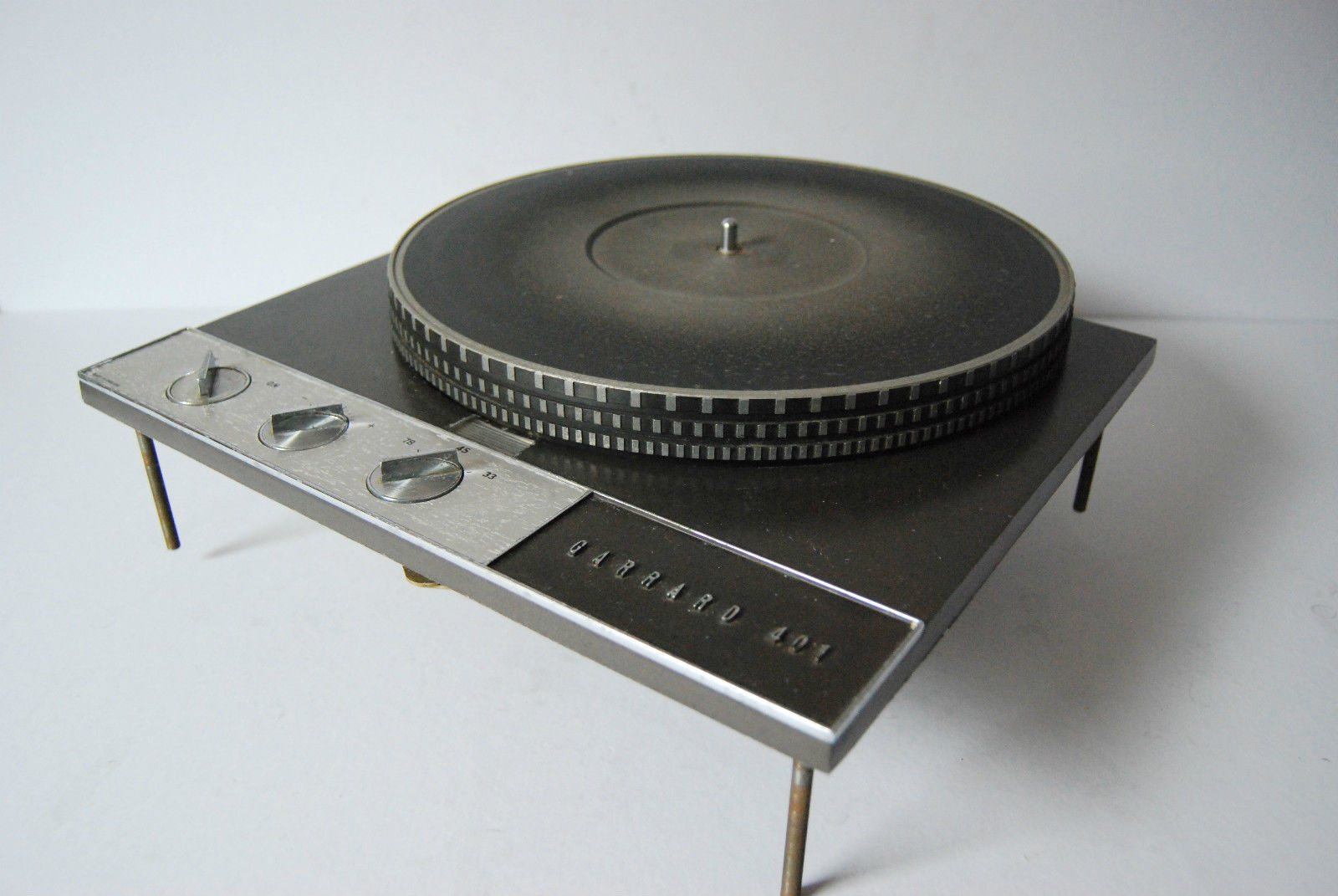

So, this is on the way:
May start it out in a plinth similar to what the Denon is currently in, may eventually make one out of soapstone or slate, time will tell ;)
Guess I'm gonna be busy for a while :obscene-drinkingcheers:

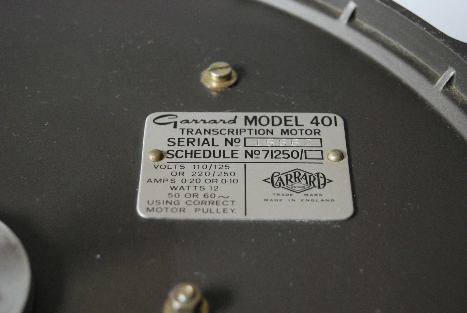

Found it on epay... Buy It Now price was a bit lower than they've been typically going for, so I jumped on it. It's coming out of Europe, so it's almost definitely a 50Hz unit, but I've already got the parts to do my own crystal controlled 50Hz supply. tomp, that's what I was going to use one of those amp modules for, now I'll just use one channel of a USA400, and use the other channel for crystal controlled 60Hz for some of the other source components.

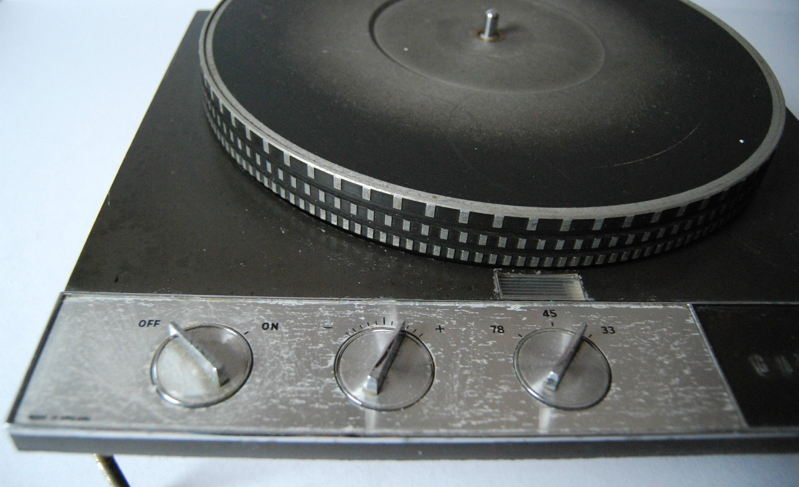

The signal generator is crystal controlled, using a 30ppm crystal. The table already has a speed adjustment, that's what the cryptically labeled +....- knob is.

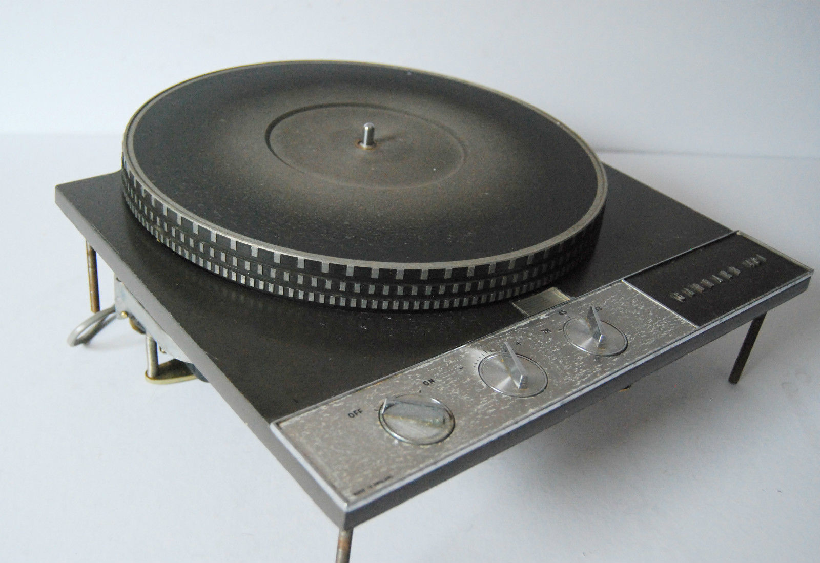

It finally showed up today. Doesn't look near as bad in person as the photos made it look. Time to get to work ;)
