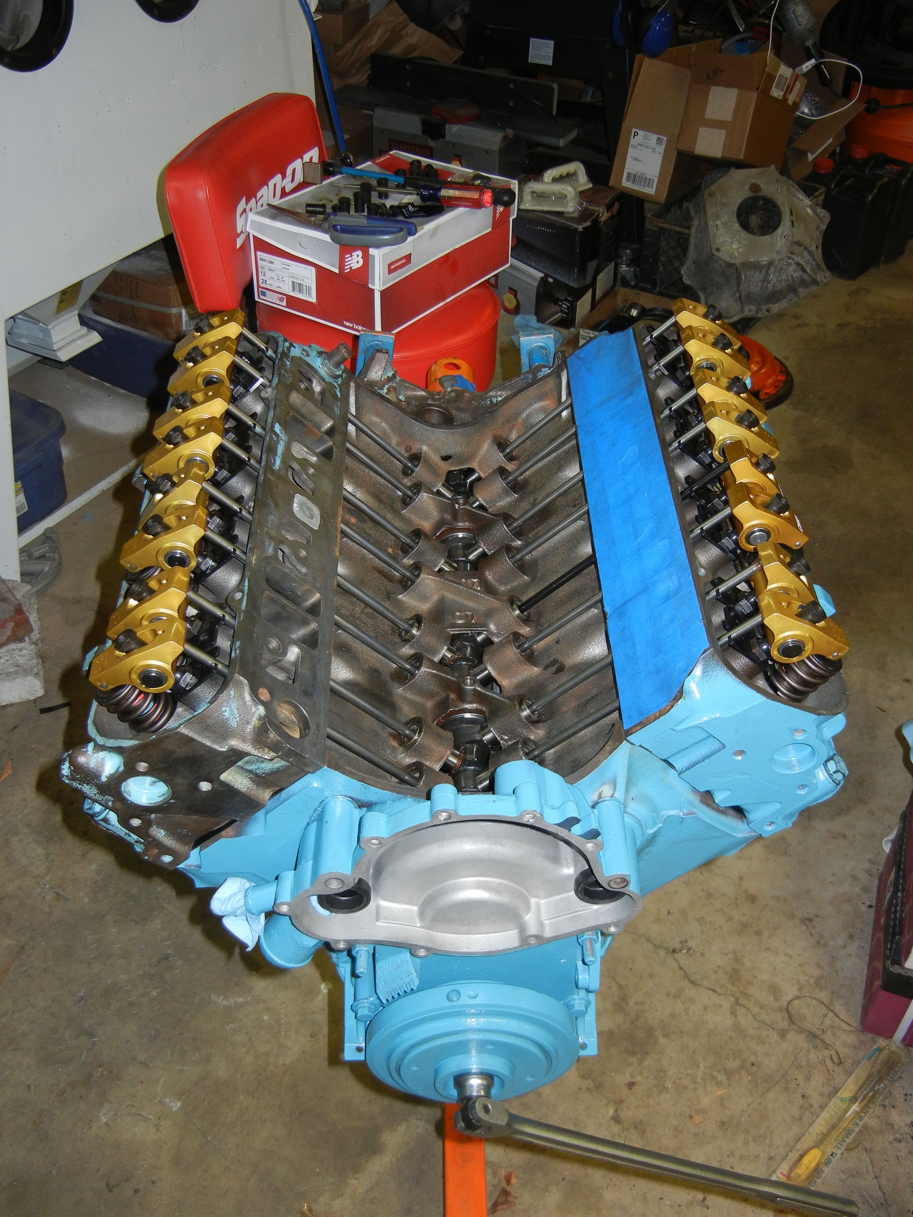

Building anything? A new race car. It will probably sound pretty good but not good in the way we think of around here.

Well, Roscoe, I'm building something but not what you mean.
I'm so far behind on my phono amp that I'm planning to build an op-amp phono amp so I can listen to music in the mean time. Suggestions accepted: I'm thinking of splitting the RIAA inversion between two gain stages and using a pair of 9V batteries as power supplies.
I have ideas for a couple power amps and a power sequencer to apply and remove power from circuits, but Life keeps interfering! I'm glad that doesnt happen to anyone else!

Nice looking project! I like the gold valve train, you need transparent plastic valve covers to show that off.
