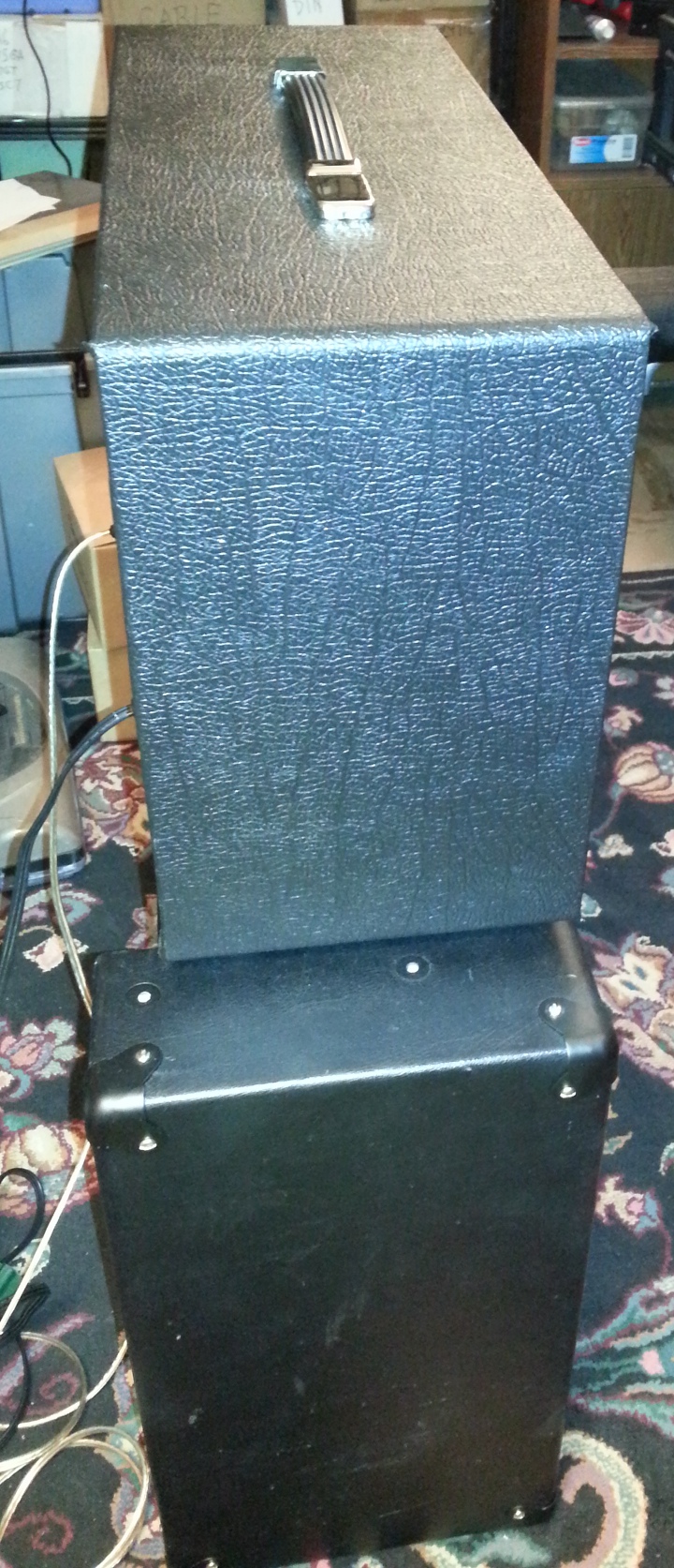

This has been a project I've been threatening to do for years! Almost complete, it finally works.
I had a month's long setback when I destroyed a perfectly good vintage KILLER power transformer with a dead short at the rectifier socket. A ground tab on the octal socket was touching one of the plates, out of sight, and the fuse (naturally) didn't blow.
Ordered a replacement (different planform :( ), so doesn't perfectly fit the chassis, but it works!
I ran DC for the 12AX7s and needed to add a small cap to ground to get rid of all hum! Imagine that, a vintage tube guitar amp without hum!
At the suggestions of musicians (who know stuff!), I built a replica of a Marshall Plexi series JTM45. Used a reproduction chassis and faceplate, built a case, and tried to stick with as much correct as possible. Obviously, the iron is not correct.
The larger output and power transformers mean that he can run any of the common output tubes: EL34, KT66, KT77, KT88, KT90, KT120, 6550, 6L6GC, etc. I'm supplying a printed list of bias set points for any of the tubes.
The bias check points that I added are across 1 ohm resistors, so checking and converting is easy: 50mV = 50mA.
For speakers, a kind friend donated an empty open back case, into which I added a pair of Celestion G12 Vintage drivers (on sale at PE).
Only stuff remaining is to cover the front plate with Tolex, add printed labels for the tubes, make the lad an owner's manual (few words, pretty pictures, (ADHD!), and get a couple of logos made for the front panel of the case and the speaker enclosure. I'm thinking "POLANSKY" in a script similar to the famous Marshall script.
Little bugger better like it and use it. I built my little brother a stereo: speakers, amplifier and turntable (made the plinth). He sold it for drugs!

Good job, Stuart!
That is gonna be one freakin super loud amp.
My son is worried about blasting out the neighbors with 1 or 2 6V6 amps, up to a pr of 7591A...I told him," Let them call the cops. and if you blow up a speaker, I'll buy a new one." Dupont Circle needs more rockin out, to be sure.
"Let that boy boogie woogie," as John Lee Hooker advised.
Jojo is actually getting pretty good. Much better blues slanger than me, but my main instrument was blues harp back in the day.

Thanks to all for the kind words. Compared to DIY audio, this has been pretty straightforward, still rewarding though.
Tag board is wonderful to work with. So easy to swap out components without fear of lifting a trace, or having to undo tube socket terminals in the case of PP wiring.
The real reward will be hearing my son make music out of it! Unlike J-Rob, D. McGown, Charlie, Johnny D., and so many others in the group, my only hope is to recreate the music others make, I have no skills at making music, unless playing the accordion when I was a kid counts, AND IT DOESN'T!!!
As to loud, well the Celestions are neodymium magnets and 98dB/W/M, so considering I used a 60W hi-fi OPT (probably can do lots more, mid-band) and a big power transformer, I'm guessing well over 60W output. Since the speakers can each handle 60 watts, well, maybe 115dB if someone pushed it. I guess that's loud, even at Roscoe's horn loaded house!
