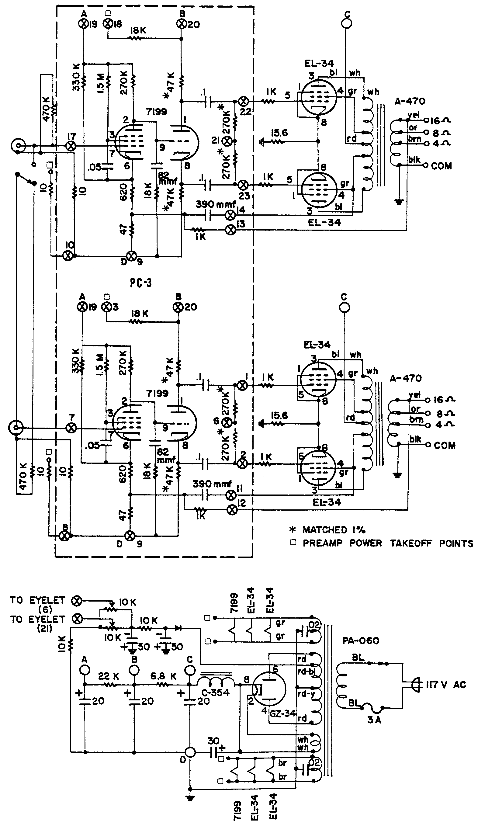

Hmm, if all the tubes went dark, did you check the fuse? I think there is a 3-Amp fuse in the primary of the power transformer. There is schematic attached to this post. If the fuse is good, the tube heaters should light up unless the power-transformer primary and/or both heater secondaries burned out. If you have a multimeter you can carefully check the primary AC voltage and heater AC voltages.

I believe the power transformers do have a fairly high failure rate. It is the output transformers that you really want anyway. You can get a replacement PT here:
http://triodeelectronics.com/mq060.html
But definitely check the fuse first!

Yeah, and everything inside the dotted line needs to go :o

Okay, so if you unplug the amp from the wall and measure resistance between the two prongs of the wall plug, you should see low resistance (< 100 Ohms?) If not, then the fuse is bad, a wire is broken, or Roscoe is right and the primary is open so the power transformer should be replaced.
There is a section on troubleshooting in the kit manual, and it shows pictures under the chassis. Take a look and maybe the fix is easy! It's usually good to have the unit working before modifying it so you can assume any problems are caused by the new modifications.
Go to <http://www.dynaco-doctor.com/st7_mnl.pdf> to download the manual (look around this site, too, for information.) The troubleshooting section starts on page 9 (Page 13 of the PDF.) www.dynaco-doctor.com Also has a repair guide from Curcio - take a look!
If your amp is stock, there is also a selenium rectifier in the bias-voltage circuit. This should be replaced with a solid-state diode like the 1N4007. Selenium is nasty.
