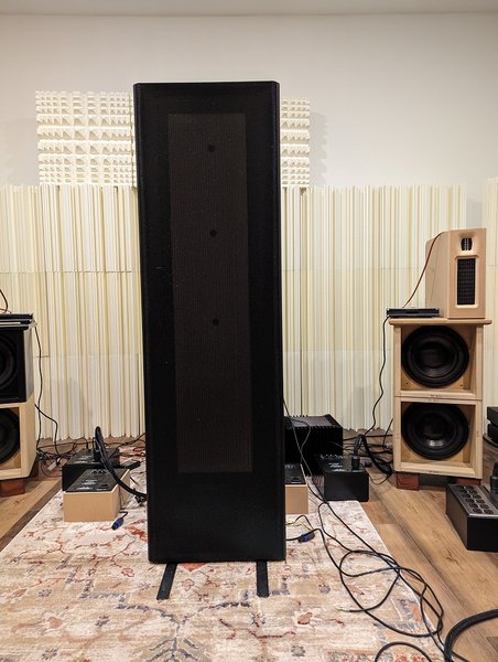

Found a pair of original Magnepan 1.7 speakers on FB Marketplace in the area for $100 for repair. This was the first Magnepan speaker to use all quasi-ribbons for planar drivers when it came out. One speaker has an open super tweeter quasi-ribbon. Magnepan sells a repair kit for the aluminum foil quasi-ribbon speakers, so ordered a kit. You purchase Acetone separately to remove the old glue to detach the quasi-ribbon material to install the new material for repair. Will pick it up in MN since I am here to visit Danville Signal this week.
Measured the correctly working speaker setup for measurement with the original passive crossover and here is the frequency response plot on center of the vertical tweeter axis. Once I have the second speaker repaired, will do a comparison frequency response plot.
This is a 3-way design with a woofer/mid planar, a tweeter planar and super tweeter planar. The tweeter and super tweeter crossovers are connected in series. My understanding is that the super tweeter is a 1 Ohm load. This is perfect to try a current output power amp for that planar, instead of a voltage output amp.
