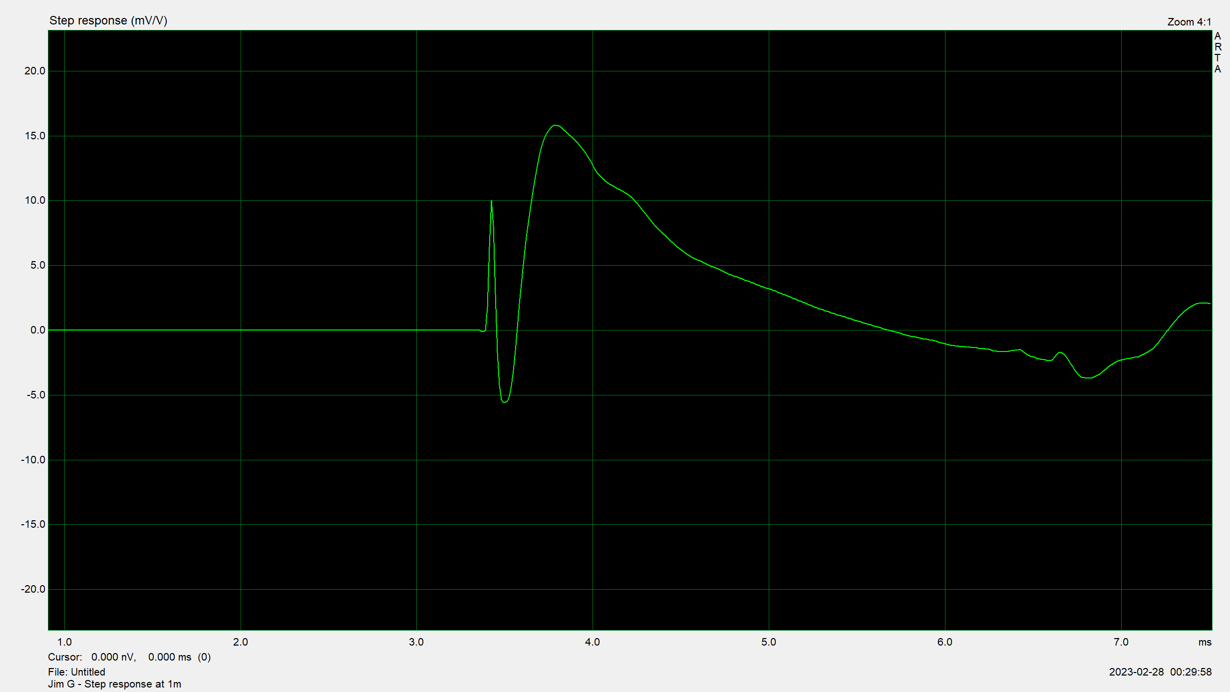

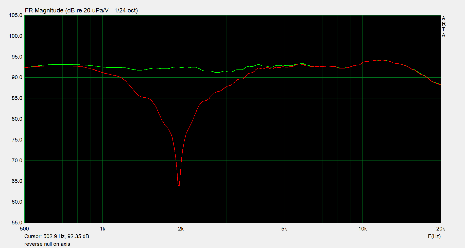

I'm not sure if Dhar has distortion measurements but they are extremely low. Here's the step response and null.

Congratulations Jim! This looks like the best of all worlds: you picked a speaker well designed that would fit your listening space; then had the designer modify it to use your preferred (and, no doubt, superb) components; then had Dhar help you by building and testing a great assembly; then you worked your own magic by doing a superb job of finishing the speakers. I'm not sure which looks better, the speakers themselves or the measurements!

In regards to measurements - the speaker components are such high quality that designing the crossover was relatively simple (minimal crossover parts).
