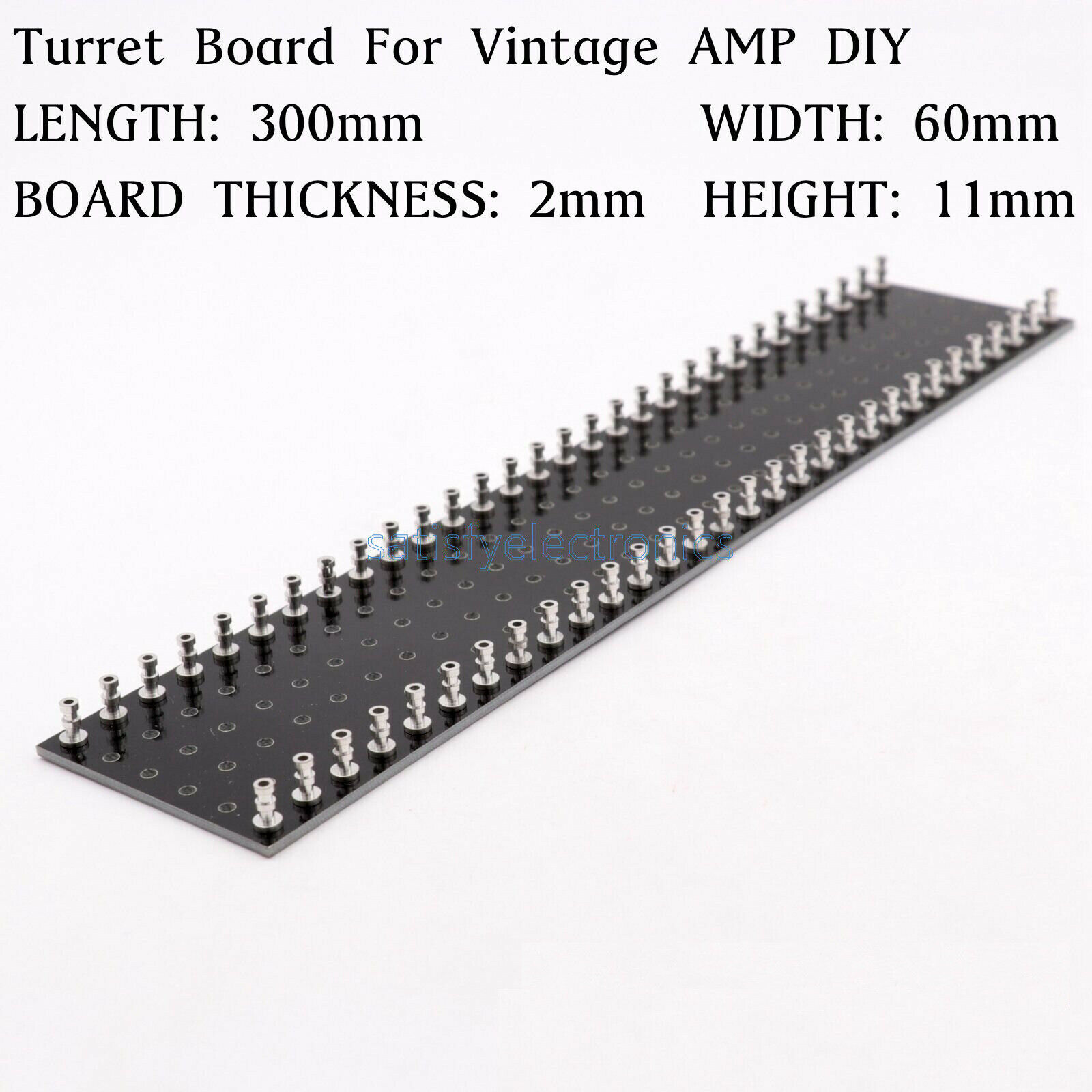

There are many ways to "skin this cat." You can create your own custom PC boards, or use perforated boards, or (my favorite) use turret boards.

might work
but it would change the layout completely.
I think it would require longer leads, which I am trying to avoid.

Turret boards come in a wide variety of shapes and sizes... They're popular with boutique guitar amp manufacturers, so places that sell parts to those guys are good places to look. I would not recommend doing you own PC boards unless you're fairly sure the crossover isn't going to change in the future, PC board traces don't hold up well to repeated re-soldering...
