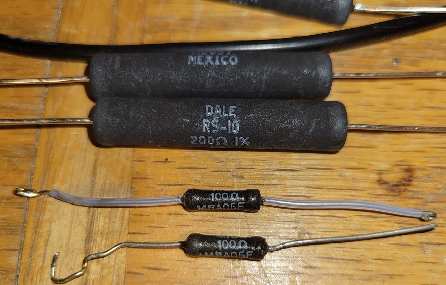

Here is a visual of the two size resistors. Keep in mind that each 5 watt Mills is being replaced by a parallel pair of 200R Dale resistors!
Not taking another chance! PITA to remove the power supply board!
