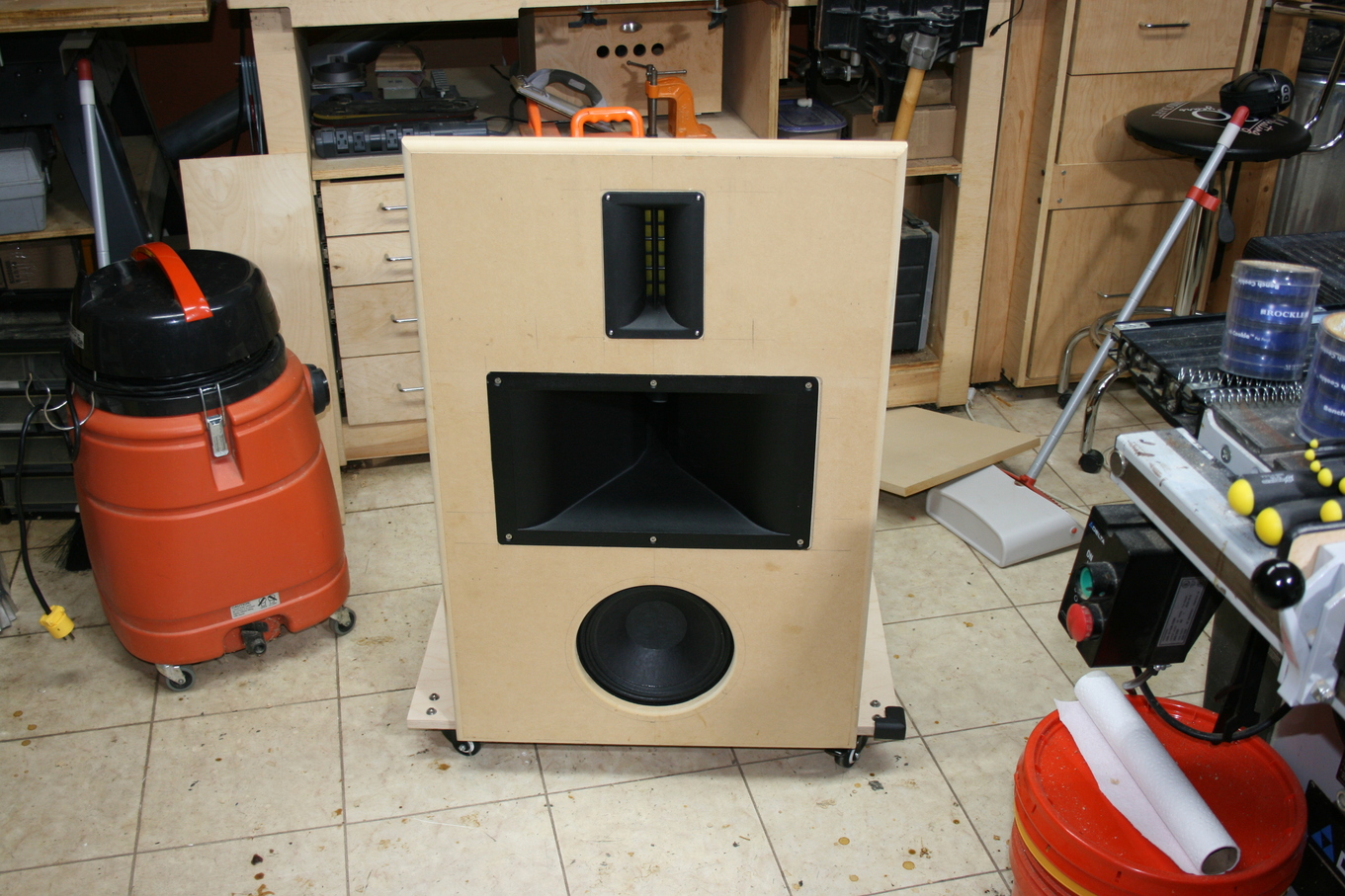

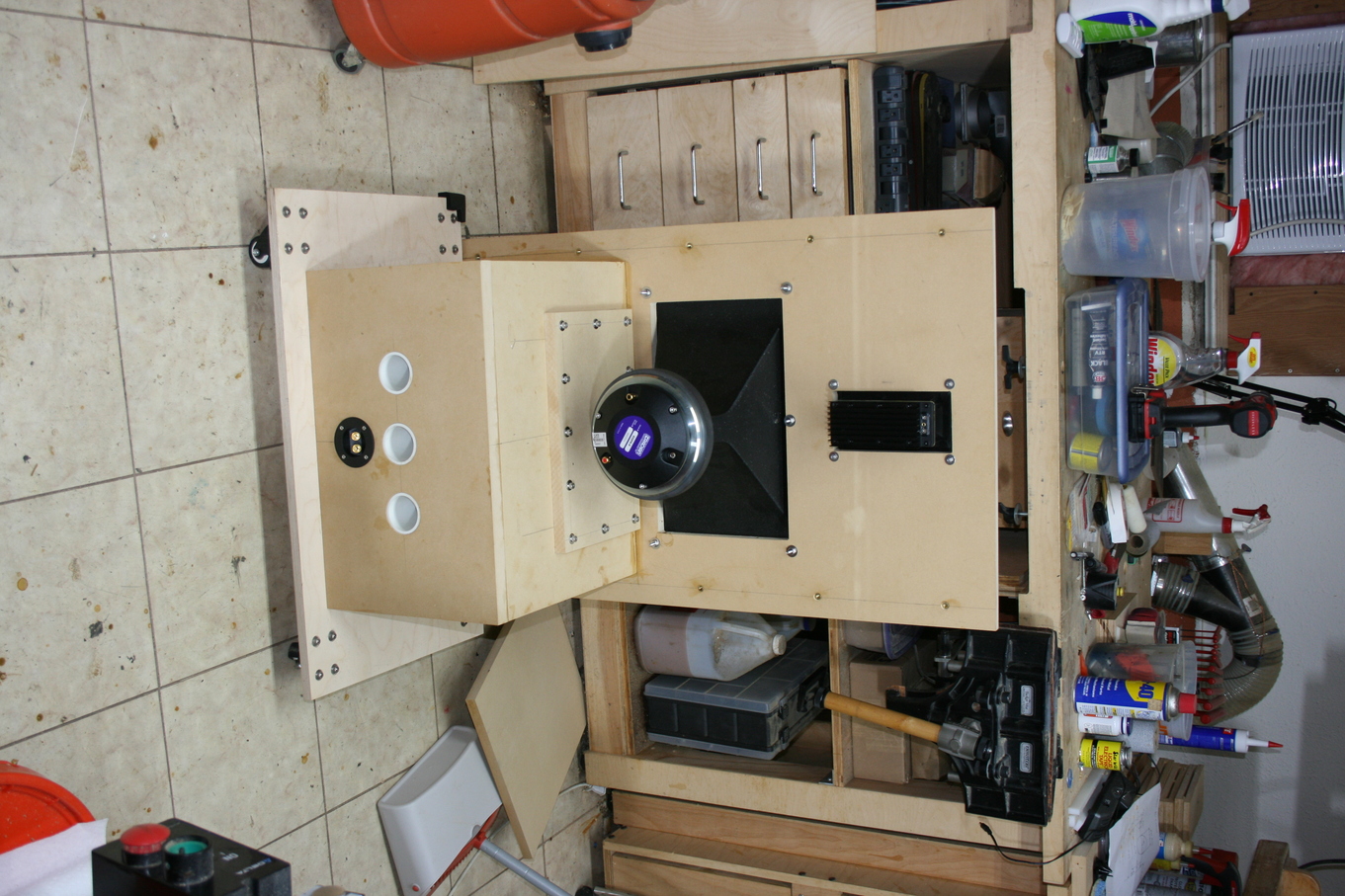

Nice work! What are the parts?
PostPosted: September 30th, 2022, 1:06 pm
I got all the drivers from Parts Express. Links are below -
https://www.parts-express.com/Radian-850PB-8-2-Aluminum-Horn-Driver-8-Ohm-4-Bolt-294-708
https://www.parts-express.com/B-C-10MBX64-10-Professional-Neodymium-Woofer-8-Ohm-294-6016
https://www.parts-express.com/B-C-ME75-2-Constant-Directivity-Horn-90-x-40-4-Bolt-294-6182
https://www.parts-express.com/Dayton-Audio-PHT1-6-Planar-Horn-Tweeter-6-Ohm-275-087

I like that speaker.
But, would a tweeter and a horn make it kinda brighter?
PostPosted: May 23rd, 2023, 7:17 am
The crossovers are at 100Hz (Subwoofer), 500 Hz, and 5 kHz. I wanted to maintain the dispersion of the system. Even thought the horn is supposed to be a constant beam width design it still going to beam at some higher frequency. I am looking for a large sweet spot.
