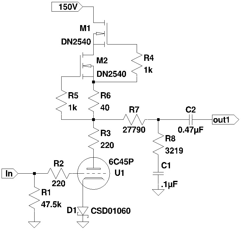

First Stage
The 6C45P has a maximum plate voltage of 150 Volts, a maximum plate current of 52 mA, and a maximum plate dissipation of 7.8 Watts for each plate, as shown in Figure 2. Forward-biased LEDs have low dynamic impedance, low noise, high bandwidth, and provide essentially instantaneous recovery from overloads (see Morgan Jones and Stuart Yaniger.) I will use silicon-carbide Schottky diodes in the cathode circuit to bias the tube, so I’ll need a bias in multiples of 0.8 Volts. A bias of 0.8 Volts should result in about 130 Volts across the tube and 30 mA of current through it. I’ll drive the plate circuit with a constant-current source (CCS), which should have about 20 Volts across it, so the first stage will be supplied with 150 Volts. Each of the tube’s grid pins (2 and 8), as well as the plate pin (7), has a grid-stopper resistor to limit radio-frequency (RF) oscillation. The grid-leak resistor sets the input load impedance. The circuit is shown in Figure 3.

File comment: First_Stage_Schematic
Figure 3: Schematic of First Stage

You are putting a highly non-linear device in the cathode circuit of your first stage. You can use one or more diodes to bias the tube, but you should pass a large dc current through the diode from an external source to linearize the circuit. One example I did was 0.2 mA through the tube and 50 mA from a very clean dc source through a wire-wound resistor. This puts the dynamic resistance of the diode into around an ohm or two and the modulating current through the tube is insignificant for further modulating the dynamic impedance of the diode. As you have it, the dynamic impedance of the diode will be fairly high and will be highly modulated by the signal. This will create far more distortion than any transistor amplifier circuit.

Dave, how is the diode non linear? Do you mean that the diode's resistance decreases with increasing current? How big is this effect? I remember checking an LED to use in a 12AX7 cathode. The voltage across the diode didn't change more than 1/10th of a volt when current through the LED varied from 1mA to 20mA. I thought it was okay.
