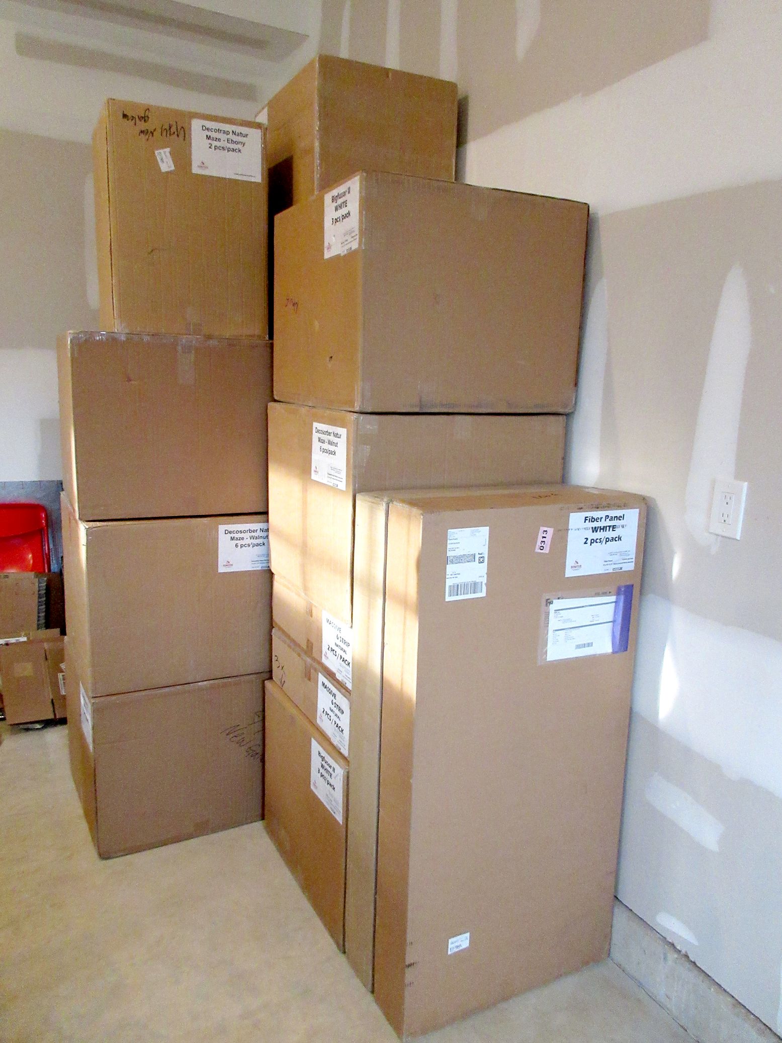

In my new house I have a dedicated audio room which for the first time allows me to properly treat the surfaces for best audio performance. The room is 20' long by 16' wide with a 9' ceiling. During construction I specified a Berber carpet and heavy felt underlayment. There are three windows that have textured shades that can be run all the way down.
Since I don't know a whole lot about room acoustics, I went to the company Sonitus USA for analysis and products. They have a room calculator on their site that allows you to describe the room and then pick the treatment scenario at three price levels. Here is a link: https://www.sonitususa.com/product/home ... ic-systems
Yesterday I received the order but because I am still unpacking and it is the holidays it will probably be a while before they get installed. I'm including a list of things I ordered and also a photos of the boxes that arrived in my garage. I ordered them early because they had a Black Friday sale with 10% off and free shipping. Looking at the stack of boxes you can see why the free freight was important. Further developments as they happen.

Just a word from my experience in the commercial sector doing noise-control projects that include night clubs and auditoriums. I've also helped audiophiles as well with "hot" rooms.
A little goes a long way. It appears that you ordered the "whole store" when you probably do not need all of it.
If you want to hear the room to evaluate it -- play some music or have your wife just talk and make some clapping noises while you listen with only one ear. Without both ears in play your brain can't do its magic and you will hear the room.
I can say this for certain -- you will not like a completely dead room. Go slow and temporary until you get a result that serves the music. You could also visit the "live-end/dead-end" methodology before you make it permanent.

This was designed by the guy who has won many awards for room treatment. It is not just absorbers which I agree would be an overly dead room. It is a combination of absorbers, diffusers, bass traps and combo diffusers/absorbers. They are all described on the site.
The placement was designed with the room dimensions, windows, and carpet as inputs. When I first walked the room doing the clap test there were areas of significant "slap echo". The nice thing about this system is that there are magnetic mounts for most of the pieces. If they have to be moved it is not like they are glued to the wall. That way the room can be fine tuned by ear with different types of music. Not only can they be moved but changes of the types can also be make. The only fix would be to fill a few holes that hold the mounts and touch up with paint.
