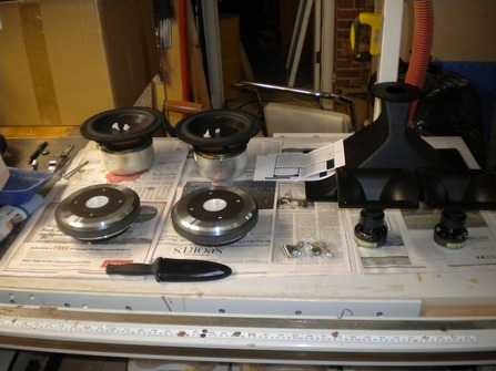

Just got some toys to play with (still waiting for second midrange horn from UPS) -
Parts:
1 - Scanspeak M22WSR-46 8" Paper Cone Shielded Woofer 8 Ohm
2 - B&C ME75 2" Constant Directivity Horn 90 x 40 4-Bolt
3 - Radian 850PB-8 2" Aluminum Horn Driver 8 Ohm 4-Bolt
4 - Eminence APT 200 Super Tweeter with Bi-Radial Horn 90 x 90
The system will sit on top of an 18 inch subwoofer. Crossover points are:
1 - Subwoofer to midbass 80Hz or 100Hz (any suggestions?)
2 - Midbass to midrange horn 500 Hz
3 - Midrange to tweeter 3.5 kHz
Suggestions on enclosure for midbass are welcome. Should it be sealed box, ported box, transmission line, or horn loaded?

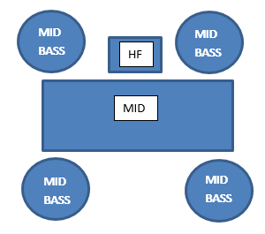

Do a Mega-Textron...???
I agree with David, you want those mid-bass drivers loafing, otherwise they will never integrate nicely.
