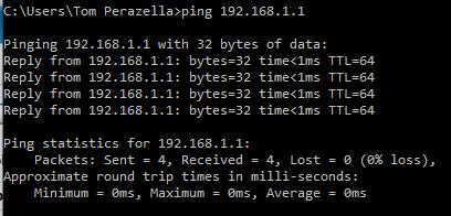

Before worrying about it, take a PC to the furthest point of your network and use the command prompt window to ping your router. Here is an example of my PC going to the router through two gigabit switches. Note that the latency is essentially close to zero. I'm also assuming that the total traffic on the network is not high enough to cause congestion which is another matter.
