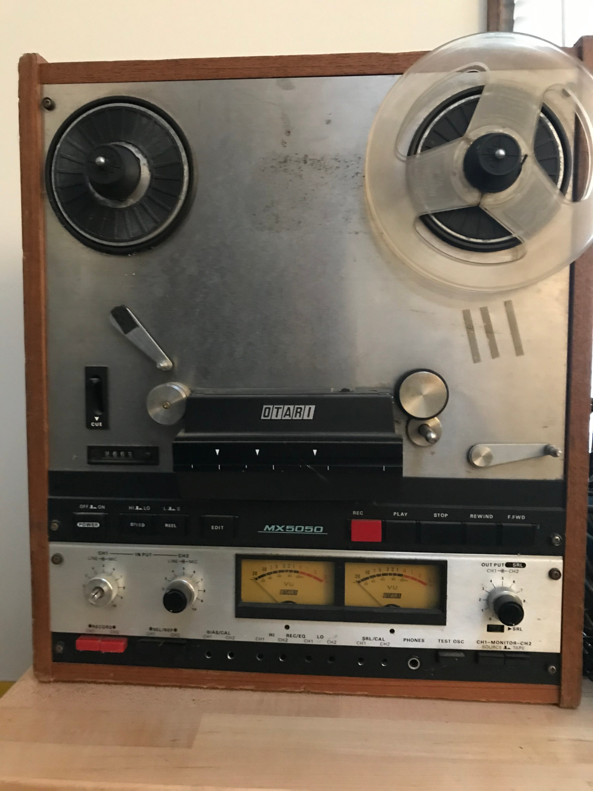

As you may have noticed in the shootout thread, I'm restoring an Otari MX5050 (no bloody "B") reel to reel deck. It's been sitting in my garage form more than a decade, and the belt had turned to complete goo, to the point you couldn't have identified it as a belt. Got a new belt put in after hours of cleaning all the goo out of where it shouldn't be, and it's now capable of playing music. Pots are a bit scratchy as you might expect, and I've got a new poly pinch roller I've yet to install to replace the dried out rubber one. Speed seems perfectly stable with the old one, but what the heck, I ordered it before I had the deck running. Now on to doing a thorough cleaning of the tape path and an alignment. Did manage to find the service manual (but not the instruction manual) on-line, so at least I have the info I need for the alignment... Here's a pic before I started (but, it doesn't really look any different from the outside yet). Not sure if the missing knob is out in the garage or not, when it warms up a bit I'll spend some time looking for it.

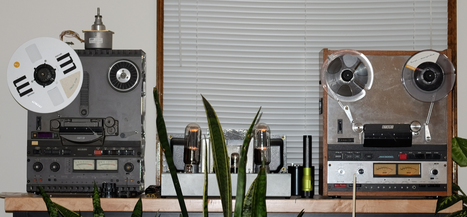

Notice that she's got a sister now, meet BII-2. BII-2 needs little help, the tape counter doesn't work, and the motor sometimes starts, and sometime needs a little twist to get going. Notice the spare motor/servo board on top waiting for me to have time to get it replaced. Took BII-2 over to Dave P's yesterday, had a great time listing to both BII-2 & Dave's twin deck. Dave's deck has a huge advantage in sound with the outboard tape pre-amp, but BII-2 still sounded pretty good. I want to publicly thank Dave for hooking me up with my first few tapes!
