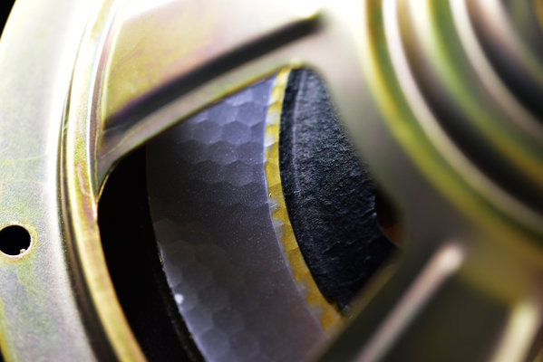

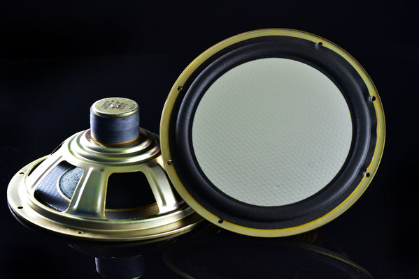

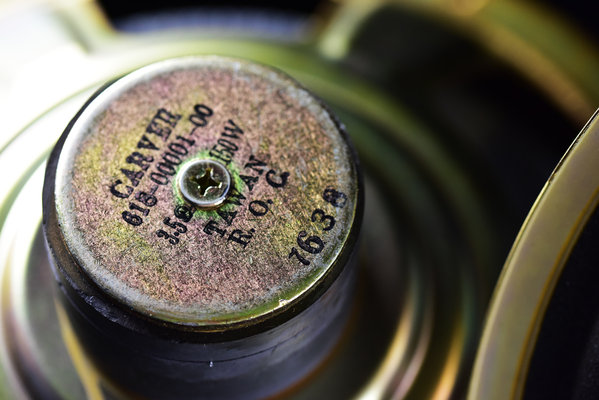

this is what the Carvers look like I have eight
