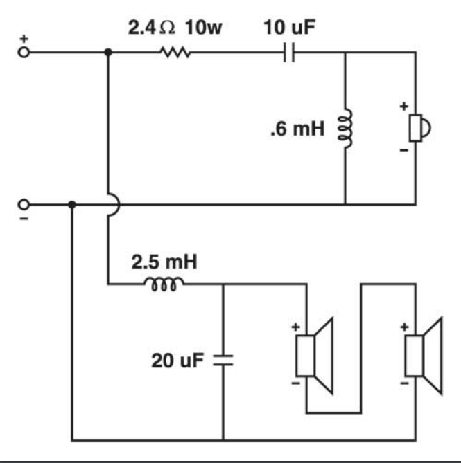

PostPosted: December 3rd, 2018, 2:43 pm
You have the schematic, just buy the parts if you must go passive.
5 parts per channel: one resistor, two inductors, two caps. Done.
