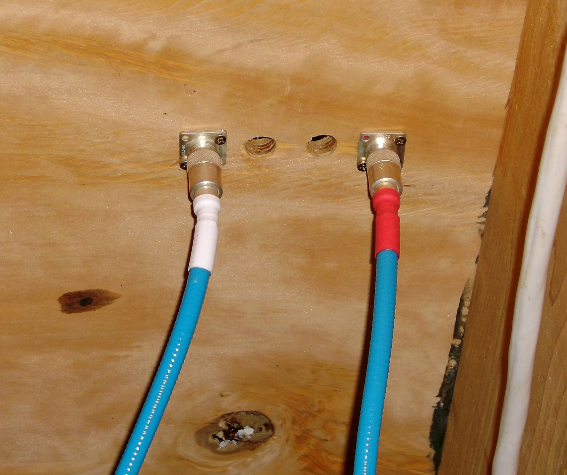

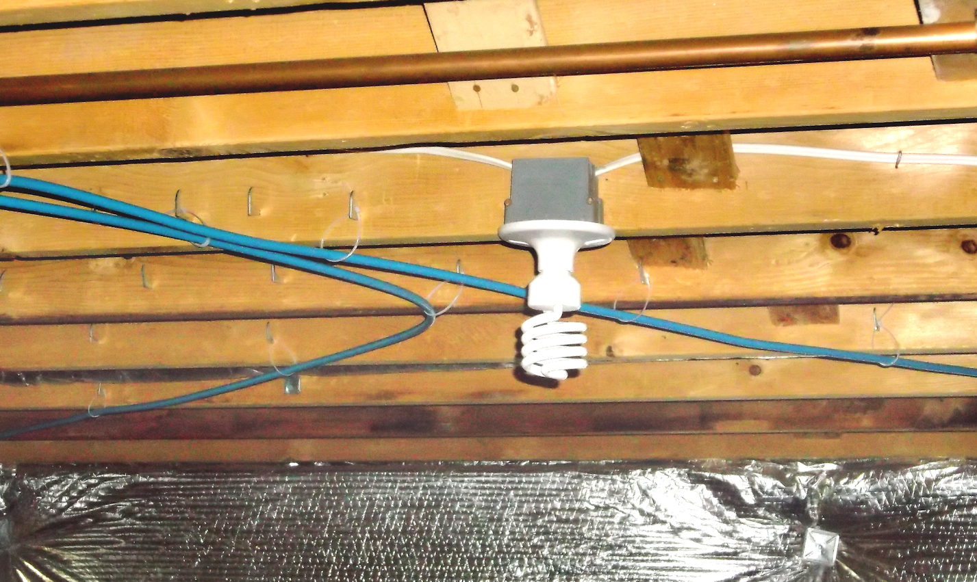

Straight up as co-ax. I have female PL-259 silver/Teflon connectors attached to the floor below the amps. and speakers terminated with twisted 12-gage stranded pig-tails that feed up through the floor to the amps and speakers. The cables are terminated with male PL-259 connectors. You might say that my house is now part of my audio system. :lol:

As it turns out that was the only way to successfully terminate the cable. It is a bitch to terminate. You need a big-ass soldering iron because between the connectors and the copper corrugated shield you find yourself soldering to very efficient heat sinks. It doesn't hurt to use a copper piping cutter and thermal stripper to get the job done. It was definitely worth the effort.
