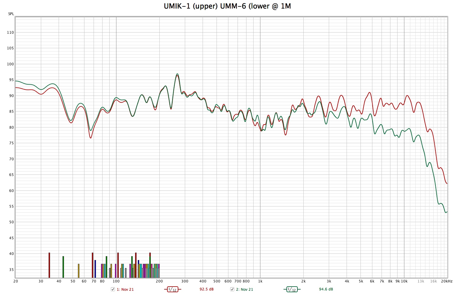

This has confounded me for awhile, and the answer should have been obvious. Still, I'm old, have tinnitus and HF hearing loss. Nevertheless, when sweeping speakers, I still hear the test tone over 10kHz.
Trouble is, when I measure a speaker, or a system, whether at the listening position, one meter away, or some other position; then adjust the treble driver for the flattest possible response, the treble seems overly bright, even uncomfortable. But the numbers don't lie, or do they? Well, if the measuring tool sucks.....
I've been using Room Equalization Wizard (REW) for awhile now, with upstream tools like analog line level crossovers, miniDSP, and the Behringer DCX2496. I admit my skills suck, I lack a lot of testing knowledge. However, the treble issue has had me perplexed: no matter how I measure them, if I adjust for flat, they sound crazy bright.
The microphone I've been using is the Dayton UMM-6, with the correct calibration file supplied by Dayton after giving them my serial number.
A quick Google search came up with a couple of threads in which users found that the UMM-6 has a pronounced rolloff, especially above 10k. One user, comparing to a CSL calibrated UMIK found the Dayton was down 5dB in that upper range. In another comparison between the UMIK and the UMM-6, the UMM-6 was 10dB down at its worst! Deviations between the UMIK and UMM-6 start showing up at ~2kHz-3kHz.
In the "pixelated" image, the lower two curves are UMM-6.

The replies have all been interesting, and I have no argument with them.
However, my point was that a supposedly calibrated microphone, with the manufacturer's calibration file, seems to be giving erroneous results.
As a pilot, we are trained to trust our instruments, not our rear ends, because the rear end (inner ear actually) will lie to you. If you can't trust your altimeter or artificial horizon, well, have your affairs in order.
Fortunately the mike seems accurate enough at low frequencies, so it is useful for room corrections/subwoofer adjustments.

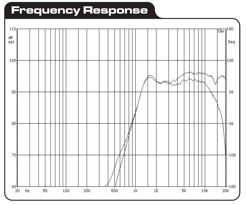

I built a set of speakers using a Dayton PT2C-8 tweeter. When I had a few guys over to audition it, Jim (Bat Ears) Gerfin, said the treble was very rolled off. It made no sense to me, since the lower treble seemed right and the data sheet showed just a small 3dB dip around 14k. I went to the website and downloaded the data sheet again to my phone, and lo and behold, there was a -7dB shelving of the upper treble. there was no change in model number, just a new data sheet. Fortunately, I still had the old one. See the snips below.
Replacing the tweeters with Fountek NeoX 2.0 tweeters proved very successful.
The ears should be the final arbiter, however, measurements are still essential. And if you can't trust your instruments.............
