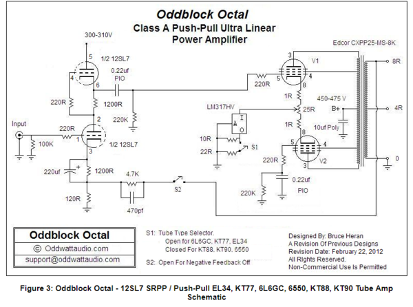

David,
Do you mean AC or DC balance? The stage is a common current sink self inverting push-pull stage. There is an adjustment pot between the cathodes and current sink. So, DC balance should be readily achievable. AC will depend on tube curves matching, I guess.
It's the Oddwatt Octal amp. See attached schematic.
Thoughts?
 Post subject: Re: Class A OPT
PostPosted: August 3rd, 2018, 3:27 pm
Posts: 236
Man, who comes up with these crazy circuits? Never seen this one. I see why it has to be class A. The LM317HV has a spec 60-V limit, so that would probably be exceeded on musical transients, especially with UL as grid to cathode peak voltages are higher. Anyway, I was thinking of dc balance. I have found that it takes as little as 1/4 mA to begin to unbalance the typical E-I core. The lower the bias current, the easier it is to keep the imbalance within reason.
