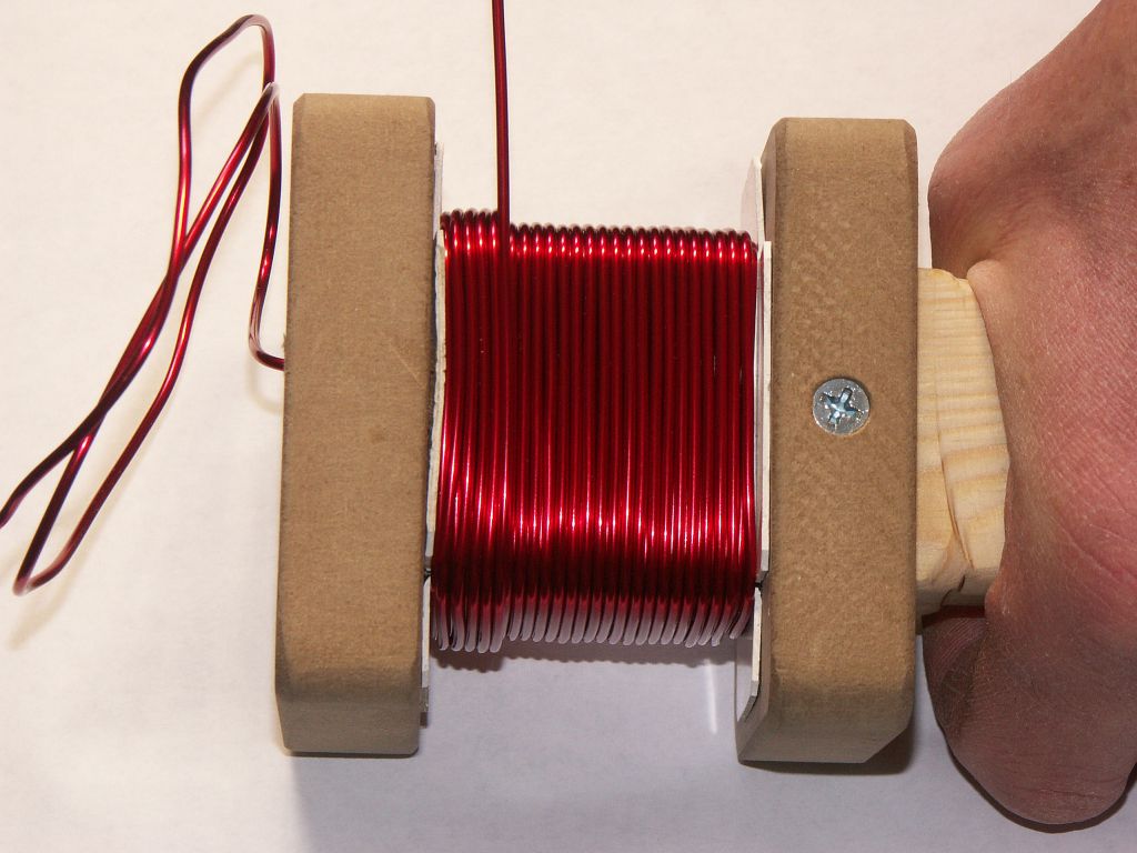

Does anyone here wind their own crossover inductors? If so, any chance you post a picture of your setup?

For larger inductors I have disassembled power transformers for the cores and I make bobbins from the vinyl stuff they use for covering wood on outside house trim. It can be easily cut and it holds a bend. I then put it on a wooden form that I make slightly larger than the core so that once wound it can slip onto the core. I bend the sides up so that the wire does not rub on the core.

Here is one of the chokes that David helped me make for my VFET amp using the technique he described. If you need core material using old cores can work but can be a major pain in the behind to work with if there was some kind of sealant used on the original piece. I'm also including a link to a site I have used when determining how to make air core chokes.
